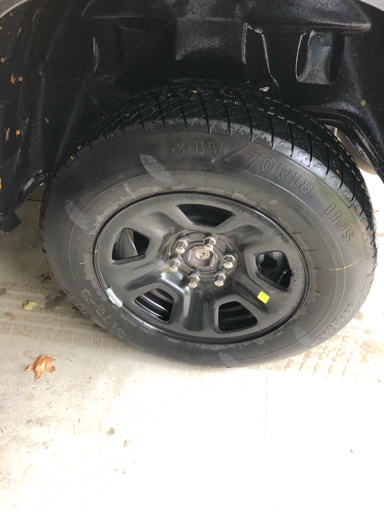

Took my blown out sidewall
flat tire off and put the spare on. So happy to be replacing a tire with 1800 miles.
