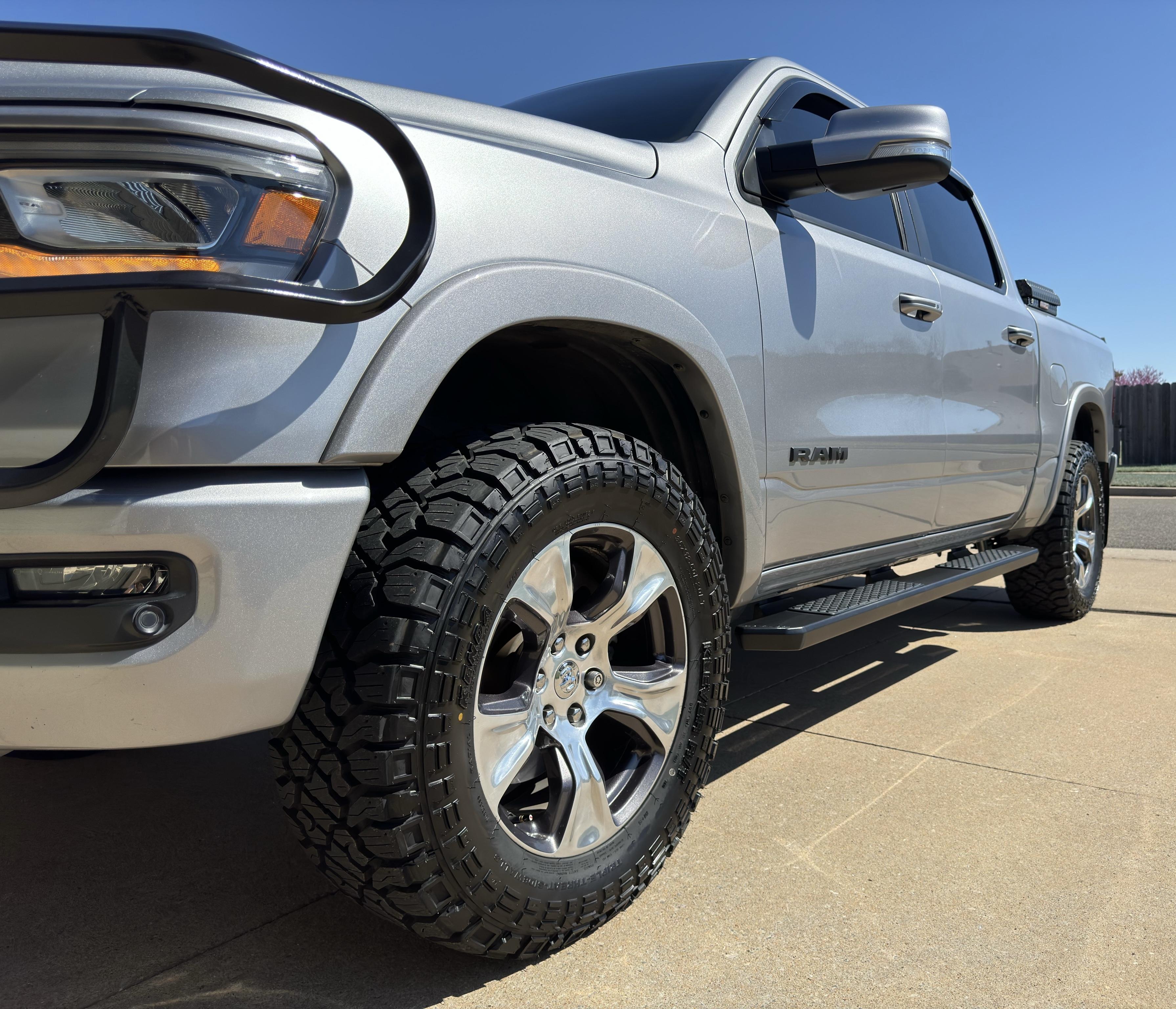

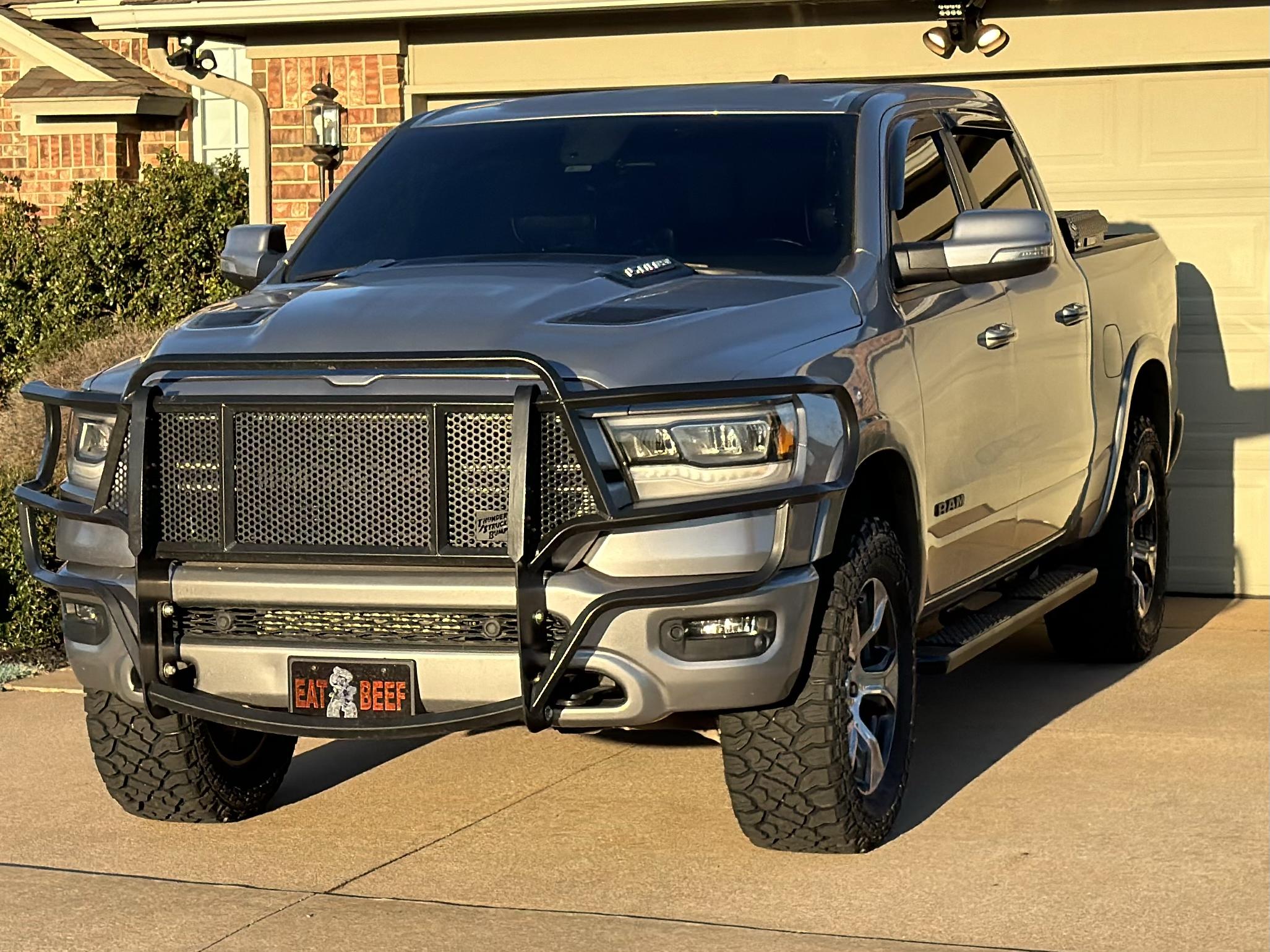

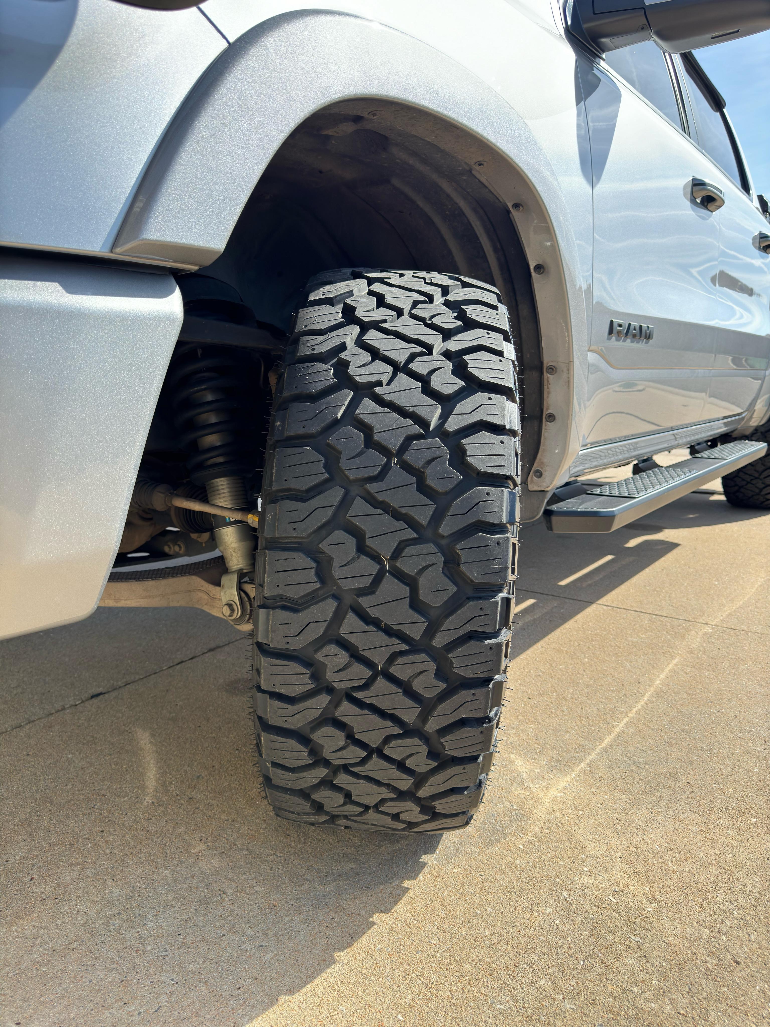

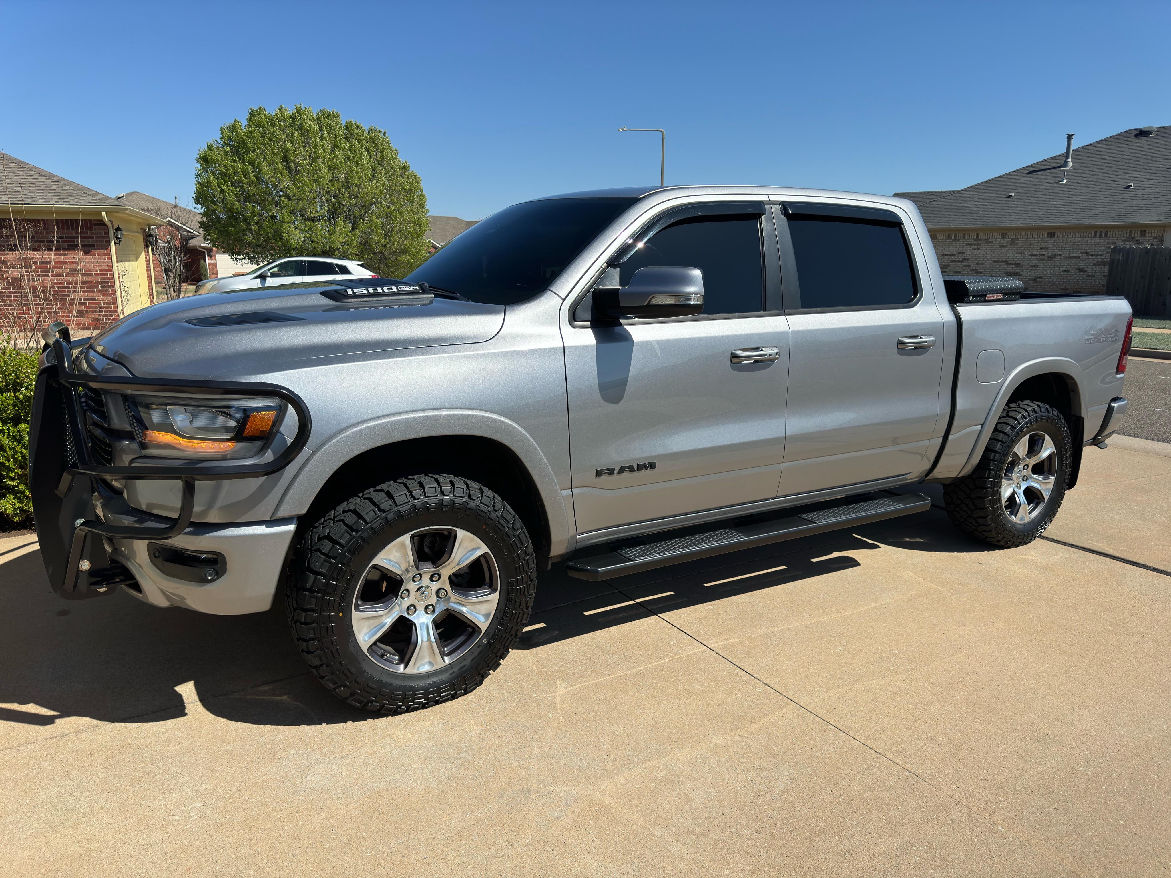

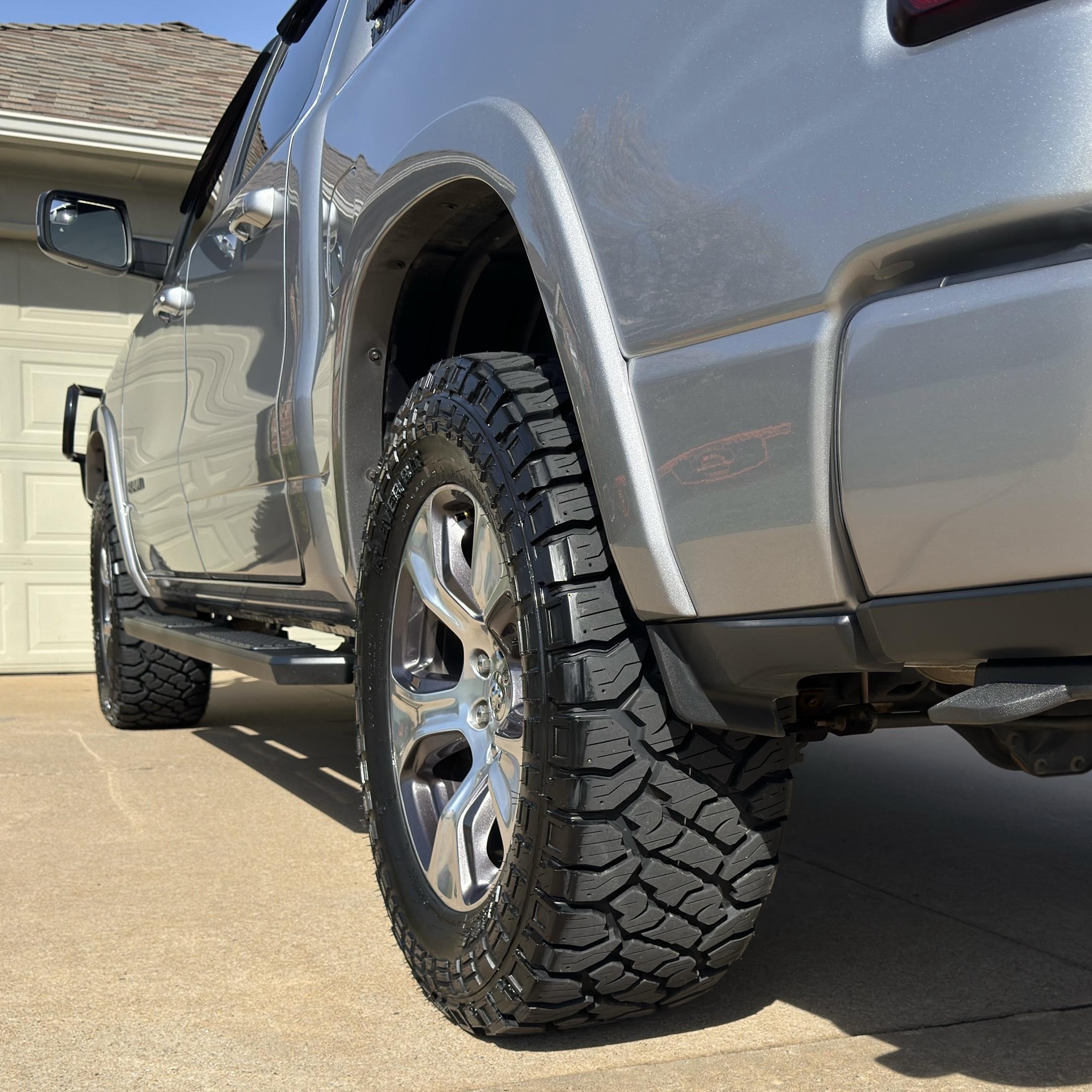

35x12.5R20LT Kenda Klever R/T’s, ICON rear springs and Bilstein 5160 rear shocks to match the 6112’s (circlip #8) up front.

Not sure how many miles you have on The klevers but I’m thinking king about getting some. How’s the ride and noise level? Any issues when mounting and balancing them?

Approximately 500 miles on them so far. Ride is a bit rougher than the previous set (LT275/65R20 Cooper AT3 XLT's), but that was expected. The front and rear Bilstein's help out tremendously in the comfort department. They're noticeably louder, but not terrible by any means - around 65 dB in the cab at 70mph. No issues with mounting or balancing.
I wondered the same thing and read the mod list and don’t see spacers. Sooo OP how close are your tires to the upper control arms?
I ran 1/4" spacers for the last 10k miles on my previous set, just to get a feel for them. Currently running without spacers with approximately 3/8" gap between tire and UCA. I'll probably reinstall the spacers on my next rotation, but there's no rubbing as is.
