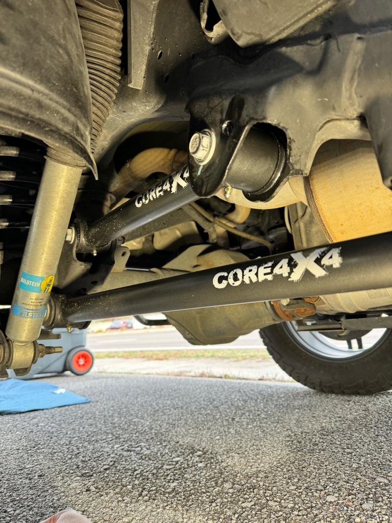

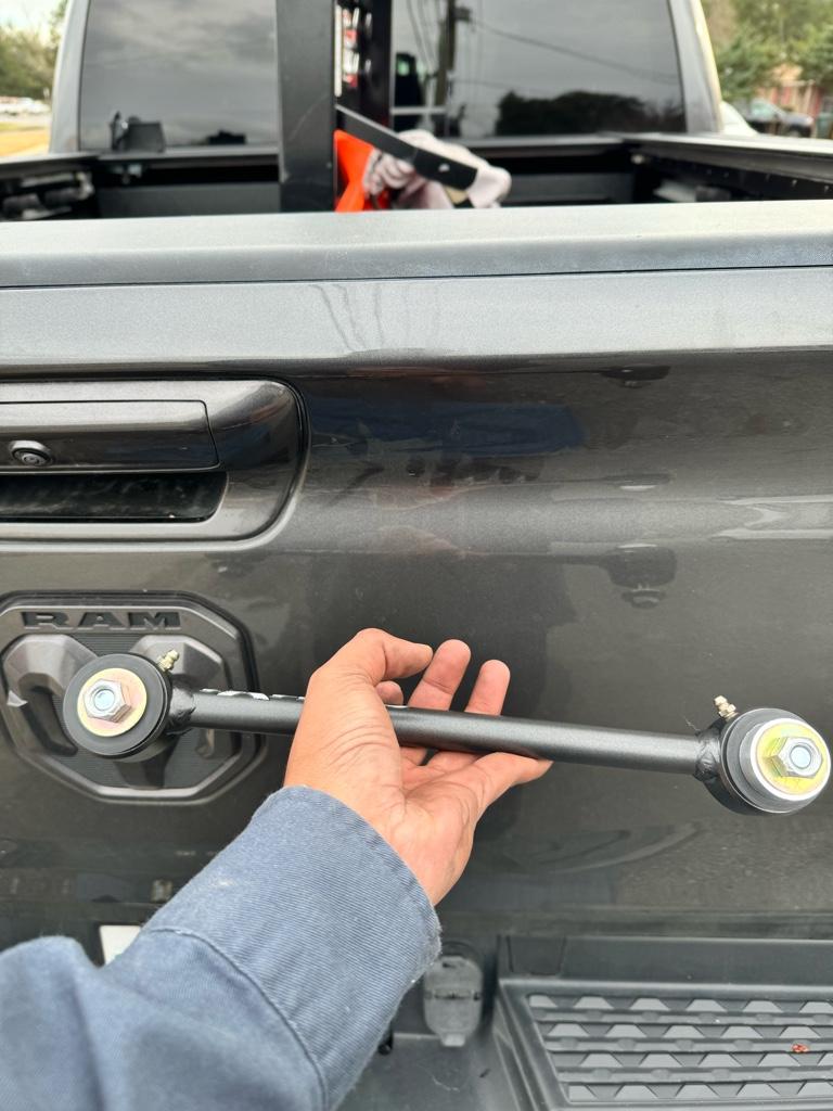

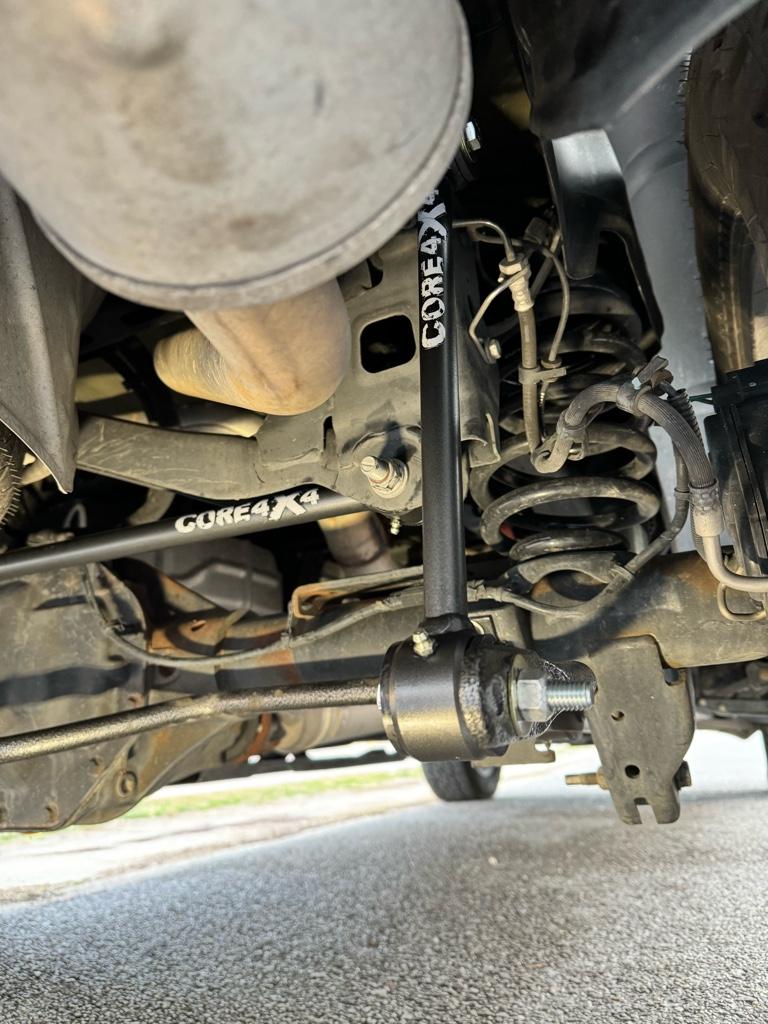

Rained stopped for a few hours and I was bored so installation happened. The torque spec on those upper and lower control arms…man. I know know I went wild with the color choice.
