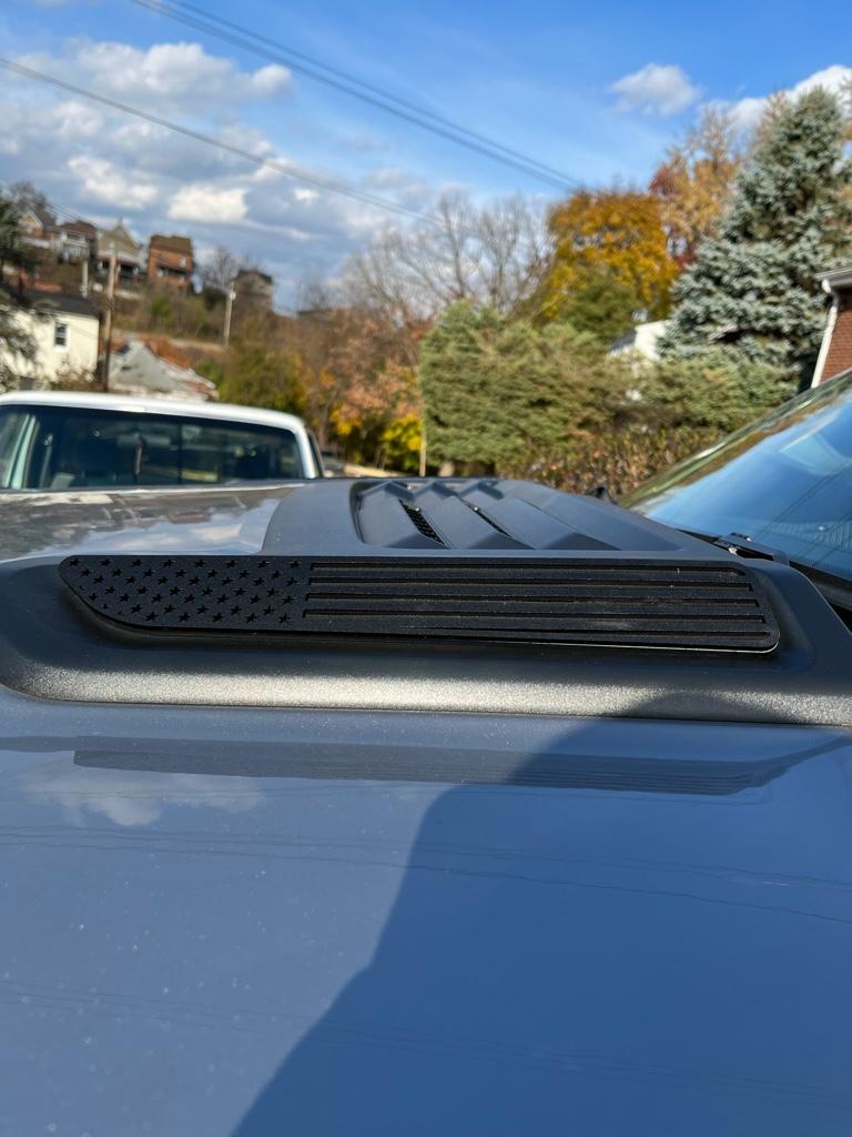

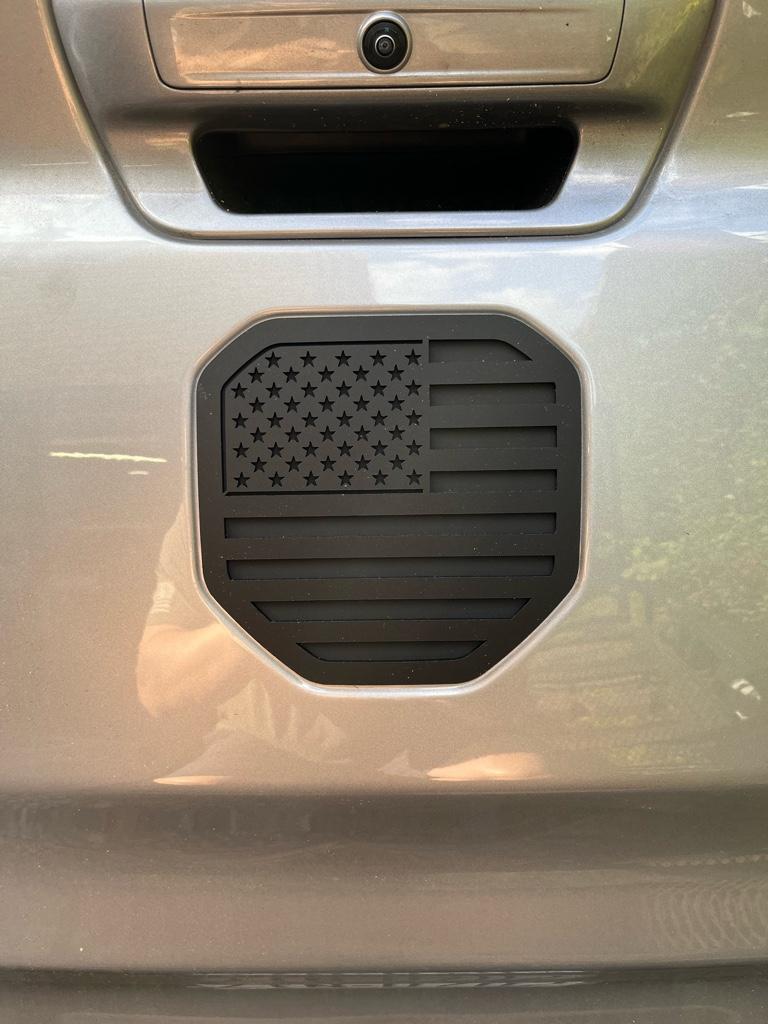

Replaced the tailgate and hood badges today
