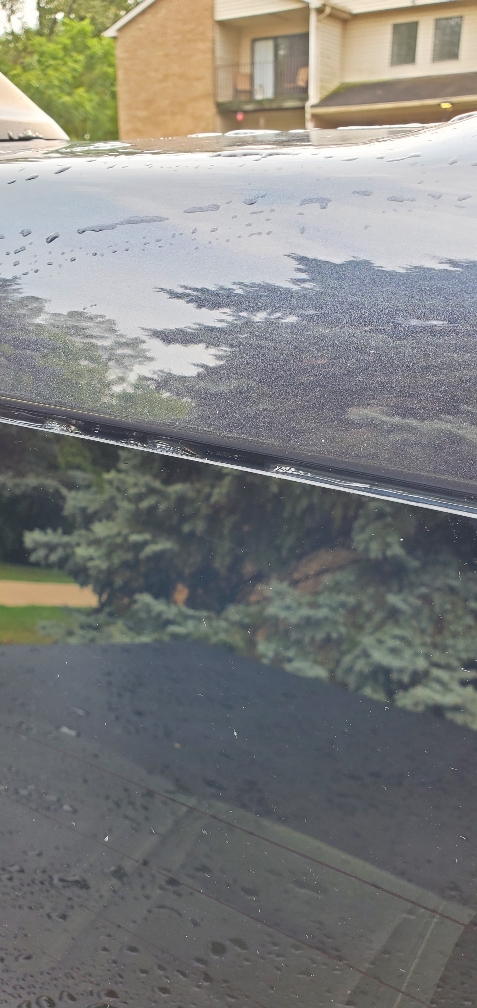

I pick up my truck after 18 days at the service center for a few issues. One of them was the infamous water leak in the rear window. Their fix was to fill the gap with caulk/sealant and call it a day. Look what they did to my truck with 20k miles on it. I've only made a handful of payments on the SOB!
There was a severe thunderstorm approaching and I only gave the truck a quick walk around before I drove off.

I called my service advisor and said I wasn't happy about the work done. He had me come in and speak with the service manager. They looked at the repair and said the only other thing they could've done was remove and re-seal the entire rear window. My response was "yes!". I now have yet another appointment set up near the end of the month.

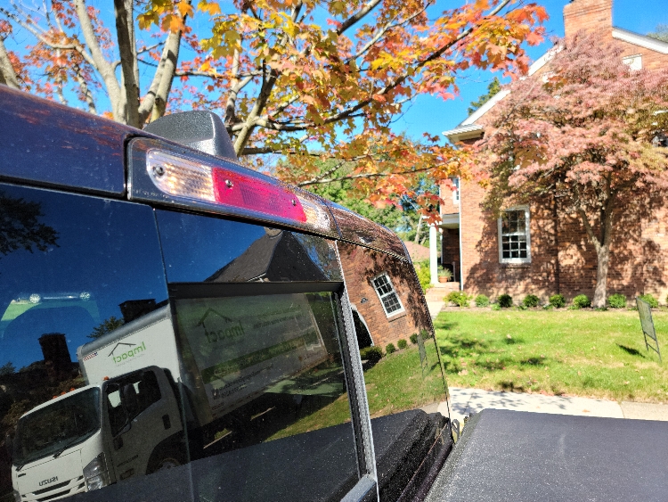

I got my truck back from the dealer the other day. They fixed their "repair" of the rear window. It was a full replacement unit done by a 3rd party. After I peeled off the tape I immediately noticed a small dent under the 3rd brake light. Upon closer inspection I can see that the new unit is slightly different than the older unit. Looks like Mopar made a design change a some point. The original unit has a plastic bridge between the left and right glass panes. Whereas the new one is thin guage stamped steel.
