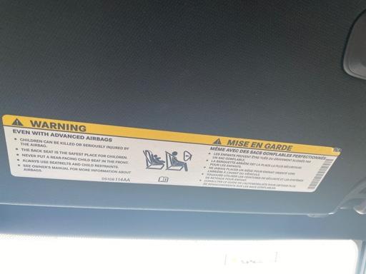

Has anyone attempted to remove these annoying visor stickers?

Wondering the same. Maybe a steamer or hairdryer?? Don’t want to leave glue residue on the black cloth.

I removed mine last week, very easy with a blow dryer. I removed the visors but didn't really need to, would have been
almost as easy leaving them in place. There is still a little glue residue ( bothers me less than the sticker ) that I'll be going
back to see if I can get rid of it. Depending on the angle the visor it sometimes isn't visible. I'll go back with a little rubbing
alcohol, soft brush and a rag to see if I can get the rest of the glue residue off.
Used this video as a guide.
I didn't want to risk messing it up by peeling it off. I made a carbon fiber sticker to just cover them up.
I didn't want to risk messing it up by peeling it off. I made a carbon fiber sticker to just cover it up. visor.jpg
Sorry, but this dude is a MORON for attempting to use alcohol or GooGone in the first place on a cloth visor. Most "intelligent" people know that, to remove any sticker, you should always try heat first. I don't think I'll subscribe to his channel :ROFLMAO:

I didn't want to risk messing it up by peeling it off. I made a carbon fiber sticker to just cover it up. View attachment 79030
Looks good, that's what I was originally trying to find. There was a company that made custom overlays a while back when I had my Charger and Challenger. So I used the blow dryer method instead and they came right off.
