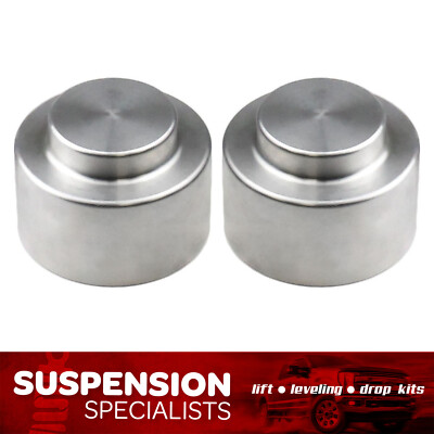

I copied the number wrong in my post, the number you provided is right and it’s discontinued. Checked on line sites and three dealers and no replacement was listed. Thanks for your prompt response, sorry about posted the number all jacked up.
Looks like this link has them.
Tried that link, ordered them and they were canceled within 30 minutes, stated discontinued item. Still trying to find install instructions from a newer Mopar lift kit to see if there is a new part number. Thanks again.

I’m trying to find out if the rear spring spacer for the mopar lift kit, part number 68233532AA, has a new part number. The current number has been discontinued and I can’t find a replacement. Thanks for anyone’s help or suggestions
what’s the purpose of that spacer
Correct, the 2" mopar comes with control arms. No need to RC arms.
Rear lift height. That's how it's achieved with the mopar lift.
