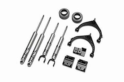

You have the "AB" kit ? Correct me if I'm wrong but I think the AB kit is updated to work without spacers.This is the AB kit and dosen't come with front spacers.Well it looks like I found out why I have 2” of rake. I was fine with it until I didnt see the 2nd spacer under the spring seat.
I was under the truck looking at the front bumper valance and seeing about removing it. I looked back and thought “Man my cv angles are flat”. I looked up and saw this...
I think the wording on this listing is the issue. They should’ve said the kit comes with the revised front shocks not spacers. This looks like the same kit I got and the spacers go on the rear coils as that is what lifts the back end, not the shocks.You have the "AB" kit ? Correct me if I'm wrong but I think the AB kit is updated to work without spacers.This is the AB kit and dosen't come with front spacers.
2019-2021 Ram 1500 5.7L Crew Cab (DT 5th Gen) Mopar 2" Lift Kit With Fox Shocks | eBay
Find many great new & used options and get the best deals for 2019-2021 Ram 1500 5.7L Crew Cab (DT 5th Gen) Mopar 2" Lift Kit With Fox Shocks at the best online prices at eBay! Free shipping for many products!www.ebay.com
So does the AB kit just use longer shocks and no front spacer? Or does it have longer shocks and just one front spacer?I think the wording on this listing is the issue. They should’ve said the kit comes with the revised front shocks not spacers. This looks like the same kit I got and the spacers go on the rear coils as that is what lifts the back end, not the shocks.
Longer shocks and just one front spacer.So does the AB kit just use longer shocks and no front spacer? Or does it have longer shocks and just one front spacer?
Got it. What has me confused is the picture for this listing doesn't show front spacers.Longer shocks and just one front spacer.
I have the AC kit.You have the "AB" kit ? Correct me if I'm wrong but I think the AB kit is updated to work without spacers.This is the AB kit and dosen't come with front spacers.
