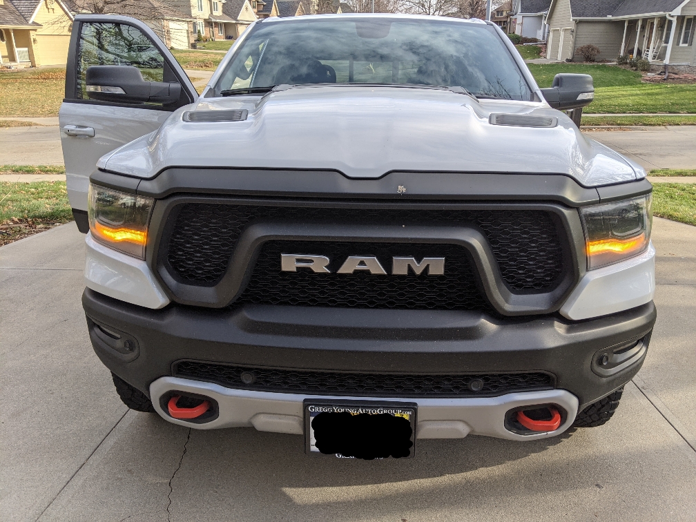

I turned the accent lights off completely while the DRLs (turn signals) are on. I think it's a much better look than having the accent and turn signals on at the same time.
You have a photo of your setup? Interested in doing this as well
Check back in the thread, I posted a picture with just the turn signals on and the accent lights off.
