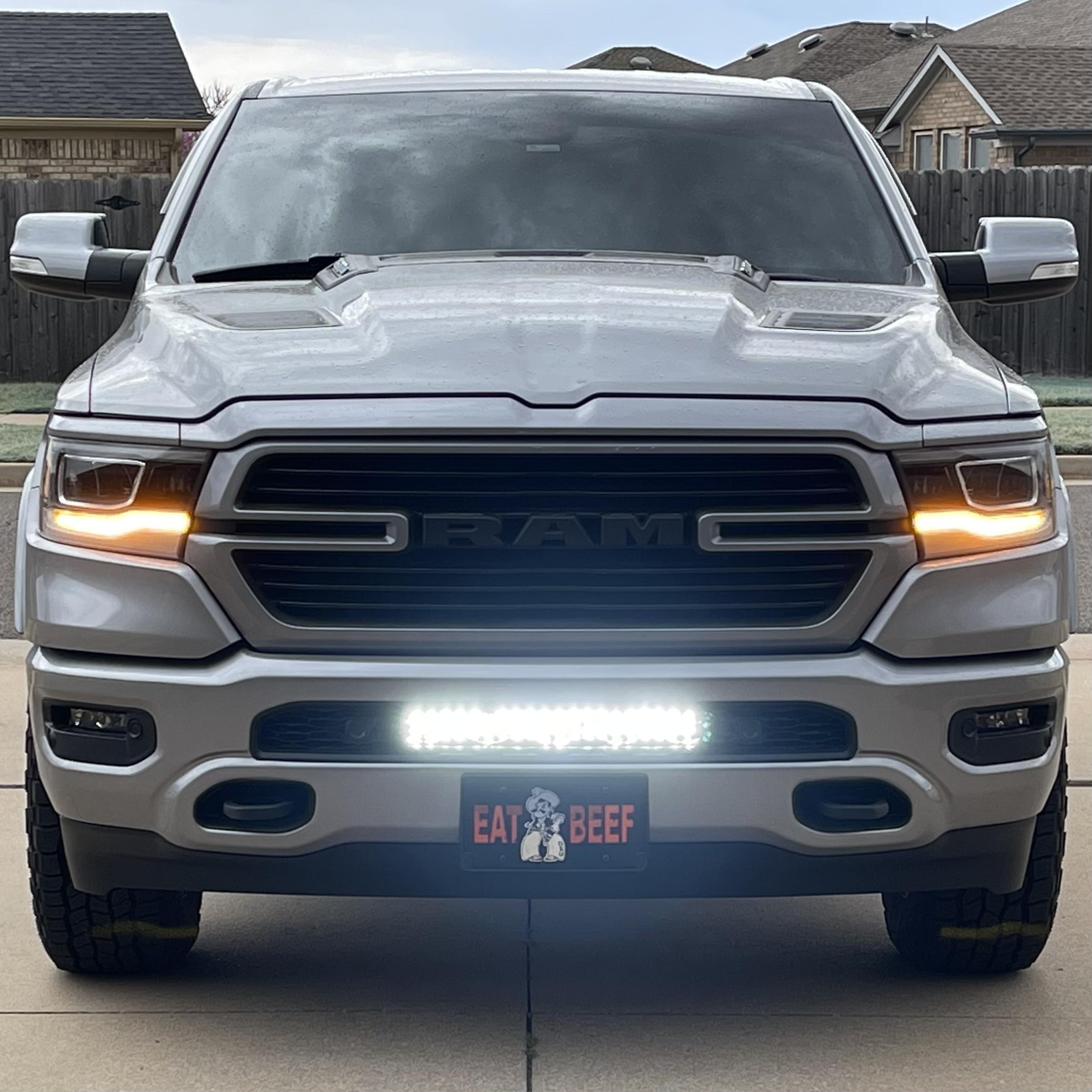

You can use AlfaOBD to disable the signature lighting (what you’re calling “eyebrows”) so that they do not come on with ignition in the run position, engine off or on. They will still function normally as parking lights when your headlights are on. I used AlfaOBD to disable the signature lighting and change the DRL location to the amber turn signals. This is what mine looks like with the engine running and headlight switch in the off position.
I can control the DRL’s through the radio if I want to go completely dark while driving. The DRL’s only come on with the engine running, so it is completely dark with engine off, ignition in run.

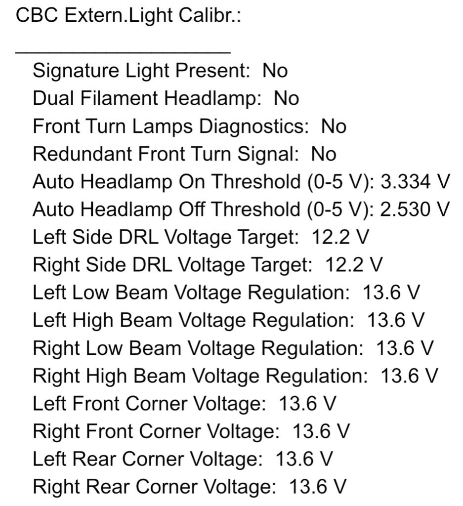

I recently bought a ‘22 Ram 1500 Limited and I also want to be able to have all my lights shut off while the vehicle is running. How do I get to the setting on AlfaOBD to have the eyebrow lights shut off while the vehicle is running?
You’ll find the setting under -
CBC Extern.Light Calibr.:
Signature Light Present: No
