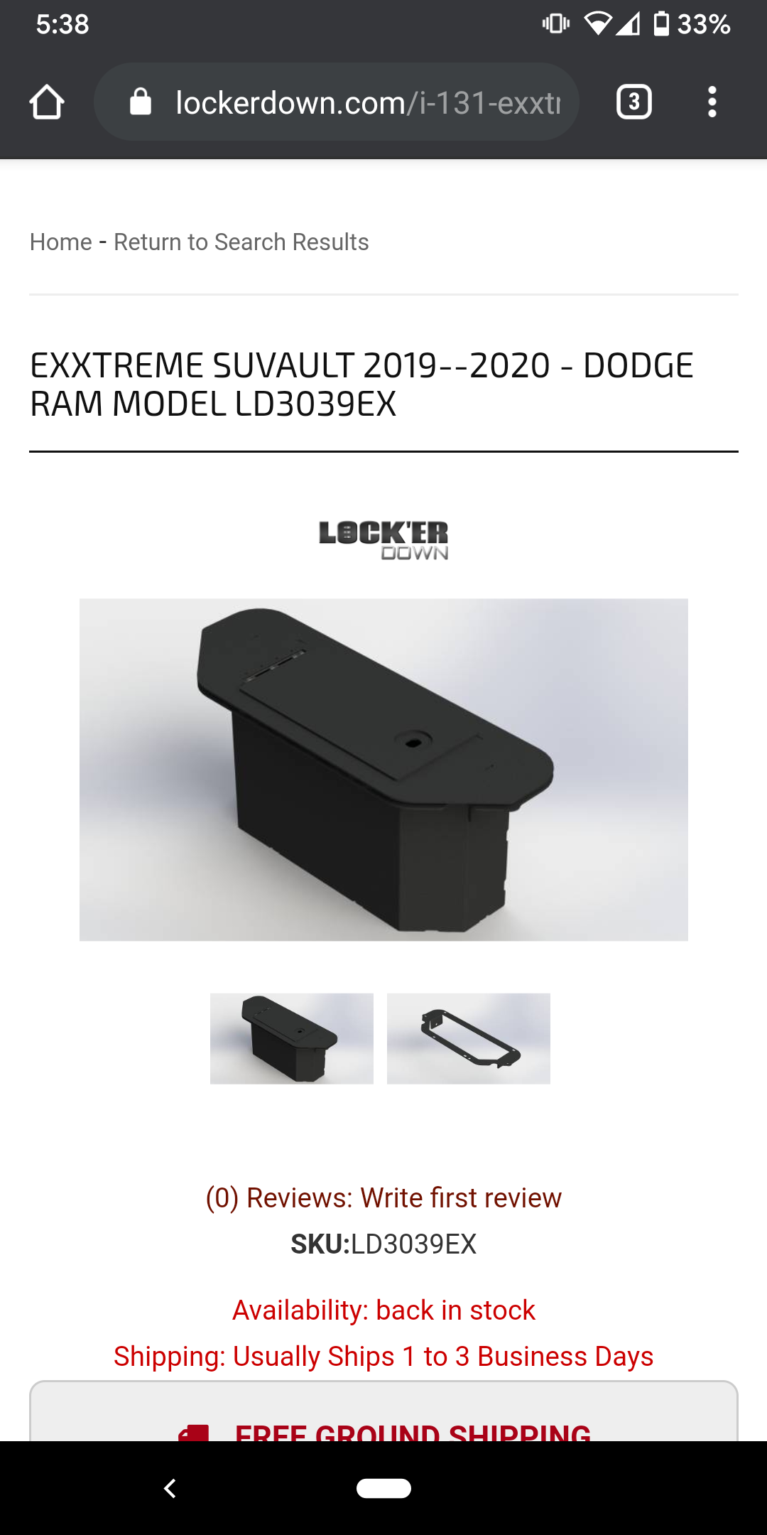

The one I bought is a drop in metal bin with attached locking lid
Oh i thought you were talking about the lockerdown console safe. Damn I didn't find that one.
