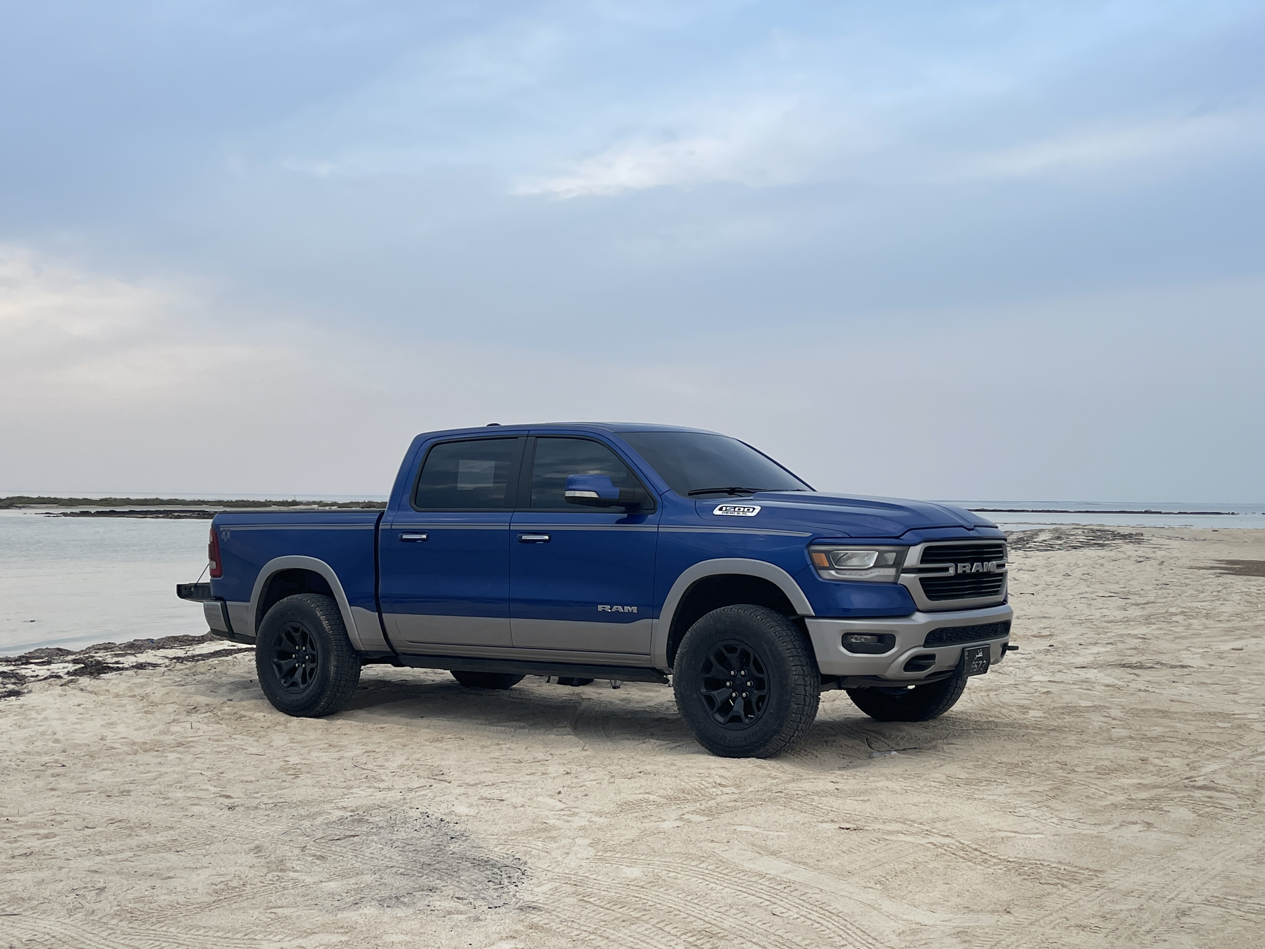

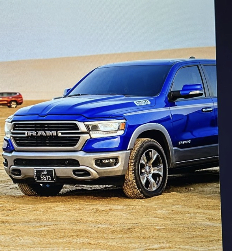

This is the photo last week
And this is is now 2 days ago
My tires are 295/70/18
275/70 or 285/65 wont rub at all.
I had the rubbing with the spacers on full turns
I had to clear the uca as it was rubbing with the tires

That looks really good. Wasn't planning to lift or level the truck but now I want to.....
