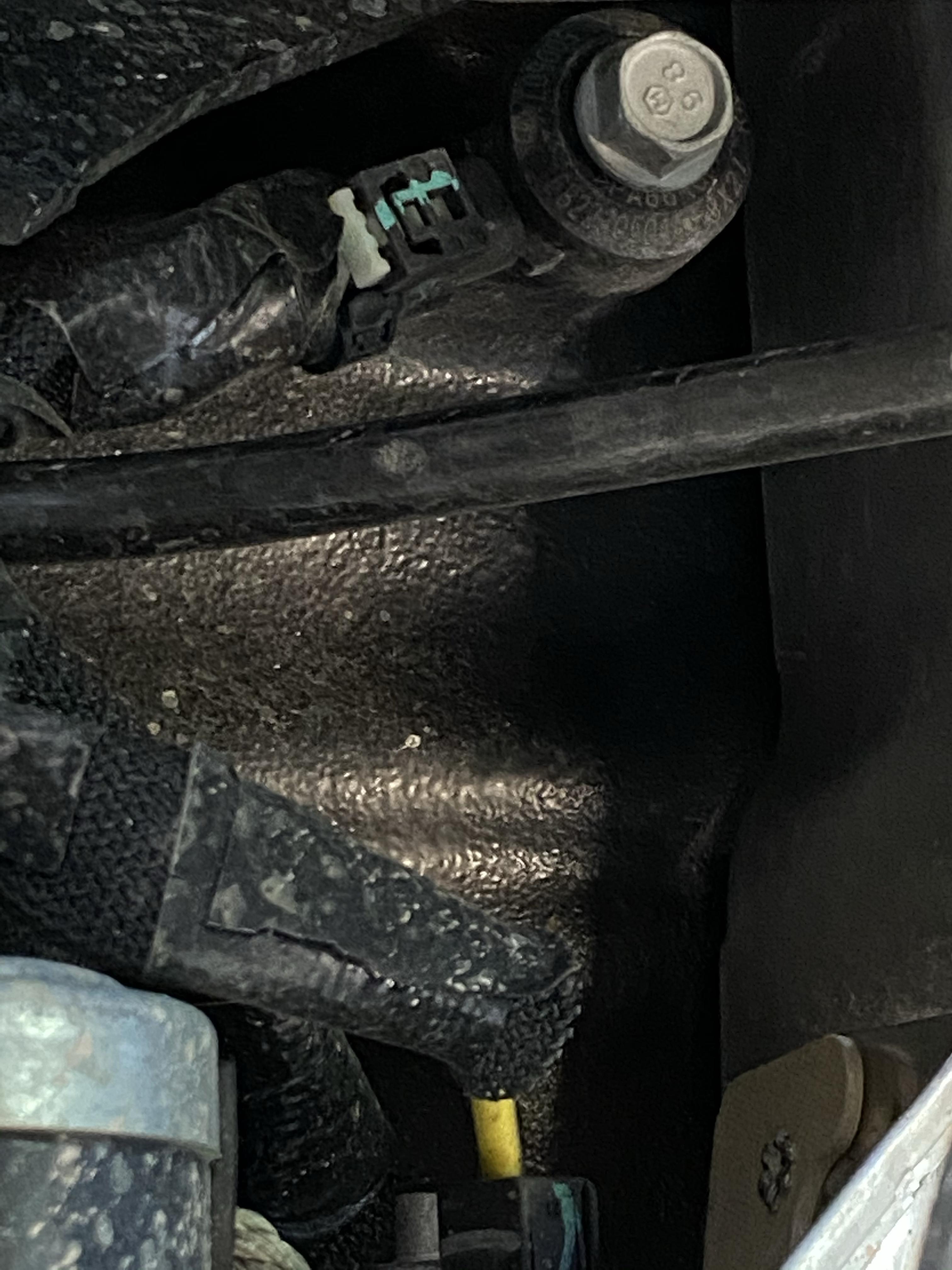

Good Question, I have been trying to find out exactly where that ground bolt it is. I would rather do it myself ...dealer doesn't have the part.

Follow the big fat cable from the negative terminal on your battery. One will go to the starter ( check there ) one will go to the block. Check there too.
Then check the ones going to the frame by the battey and make sure they are not all painted.

I suspect it’s the bolt into the block by the motor mount and starter area. It’s tight. All of my other ground connections are paint free.
