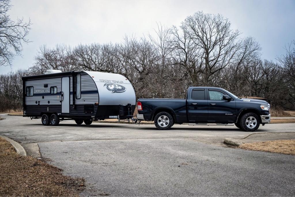

We tow a slightly smaller 23ft trailer (7500# max ) with a very similar truck, the only difference is eTorque in ours, so 100lbs less of payload. Living and traveling full time in our trailer for almost 2 years / 27k miles miles now. Zero problems, very comfortable drive and ride. Lots of power, no issues in mountains or anywhere else. MPG anything between 8-14 (wind is your main enemy)
I can definitely recommend Husky Centerline TS WDH.
Thank you. I’ll give that WDH a look. We also looked at a grey wolf similar to yours.
