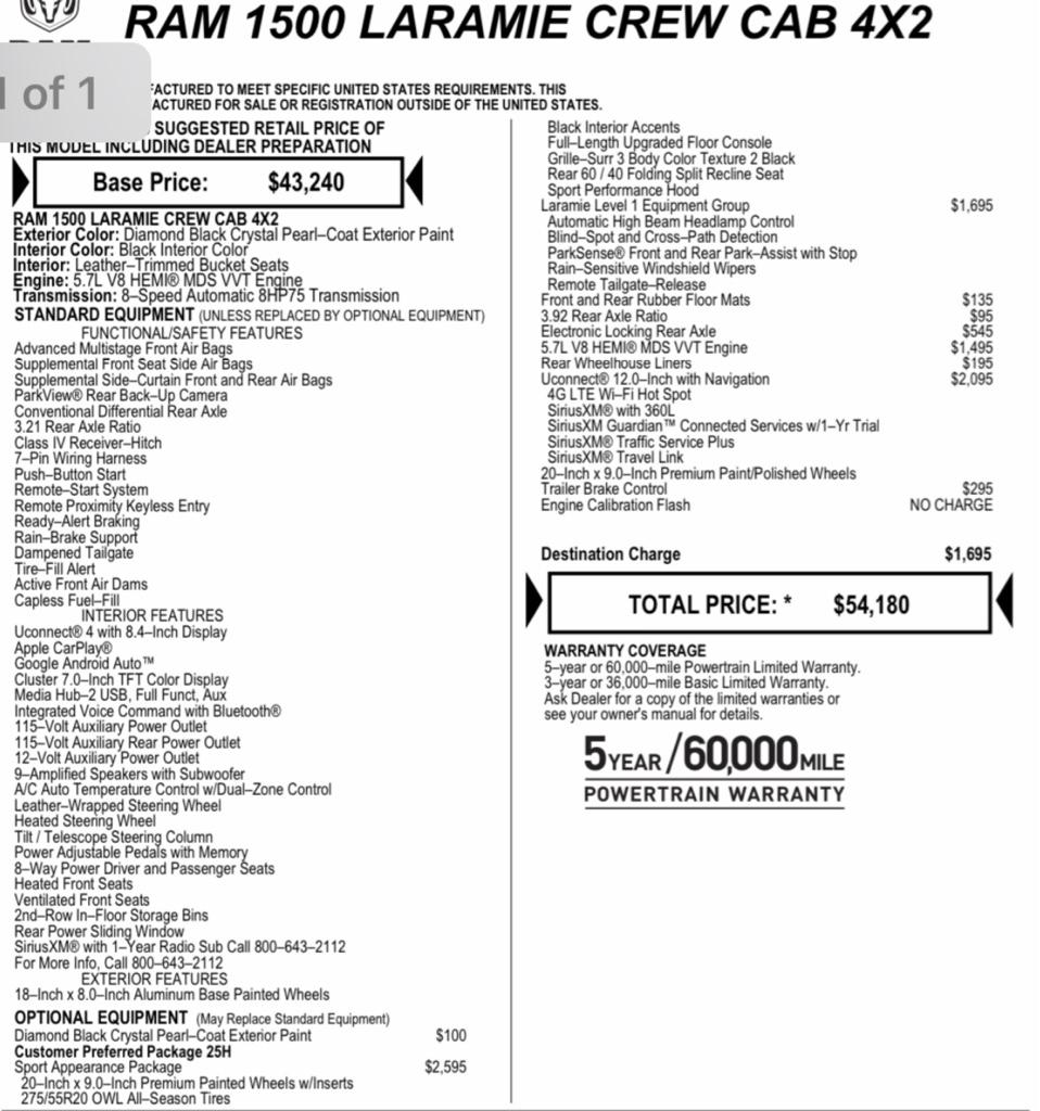

Been reading through here and other sites and still have some (probably stupid) questions on towing a trailer. This is my first truck and first time towing so trying to really understand before attempting to tow anything.

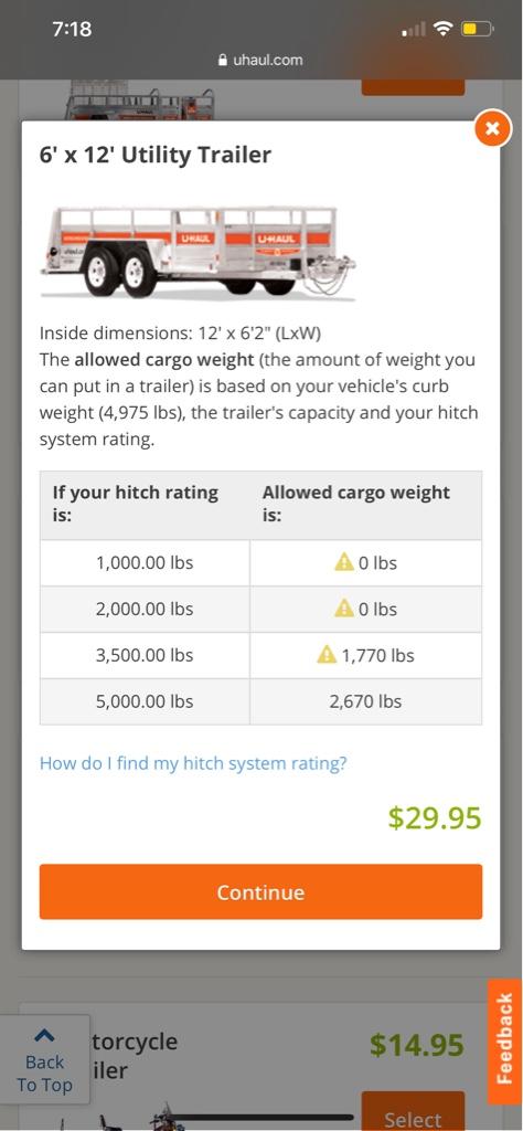

Situation: I have a 2020 Ram 1500 Laramie 4x2 (sticker with features attached for context) with some towing features and a Class IV receiver hitch . I am planning a trip to go pick up floor tile about 320 miles away (5.5hrs each way, 640 total miles). All the tile I’m getting will weigh about 2400lbs. Knowing that the tile is too heavy to just put in the bed of the truck, I am considering renting a Uhaul 6x12 (specs attached) utility trailer to attach for the trip and load the tile on the trailer.
To the experienced towers out there, do you think the 6x12 with the 2400lb load in it, attached to my truck will be fine for the trip? Trailer will be empty for the first 320miles and then full for the return 320 miles.

It’ll be fine. Load everything front to back in an even layer keeping and partial layers towards the front. You’ve got to keep some tongue weight on it or it’ll do bad things going down the road.

The trailer will tow just fine empty. When loaded you need to load the front with 60% of the weight and the rear with 40%. I believe this is right on the trailer...at least it is on the enclosed ones.
You will need a 2 inch ball. Probably won't need a drop for the u haul...but you may if you end up with your own trailer.
Most 2 inch ball mounts will be for 5000lbs and 500 tongue. Get a 7500lb ball though. Just a few dollars more.
