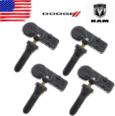

new sensors worked! Picked the up for $69 on eBay. Tire shop said one tire didn’t have a sensor 🤔. I did ask for the old ones back. Either the tire shop broke one and lied or the shop where I bought my wheels only installed 3.

Anyone ever have them ready in the wrong position? I double checked and I definitely have both fronts at 55psi and both rears at 45, but it's randomly showing them in the wrong spot.

Mine did that. When I put them on the truck, two synced right away....on a test drive around the block.... then a 3rd one. Then a few minutes later I drove it again and all four were "synced" but the driver side are showing up backwards. Front tire is reading at the back location, vice versa.
I have not checked lately, but it stayed that way. It has only been a couple weeks and I don't drive it much so I'm not sure if it's "fixed" or randomly changes, etc...

I asked the ebay seller about the issue and he said "New sensors are dormant, they need activated to wake up in order to sync while driving."
Does that sound like BS? I thought with the 5th gen it auto-recognized them and they were ready to rock out of the box.

Only during a rotation when the tires where actually switched. They would then synchronize at around 5-10 miles of driving.
jeffrey5679
Oct 2, 2020
98
17
They automatically sync. Took about 10 min or so of driving. Tpms I used worked flawlessly. The link is on this post

Yeah, this guy is full of it and/or just doesn't know what he's selling. Sucks because I'm not sure if it's one or all of them that are the issue and it costs a bit to dismount and remount a set of 35's if I wanted to replace them.

Mine are still "working" but the tire locations are still wrong. Today, both driver and passenger sides have the readings backwards. F/R are flipped

Mine now seem to come on (in the wrong locations) for about 10-15 minutes of driving, then it switches to "Tire Pressure Temporarily Unavailable."
I went ahead and got a new set of OEM sensors (for sure OEM, not ebay or Amazon) and I'm going to have them swapped out soon. Hopefully that takes care of things.

My first set acted just like you said even though some had ordered from them and had no issues.
These were my initial ones that didn’t act right. All working randomly. https://www.ebay.com/itm/153698410883
These were the set that has worked perfectly.
Mopar 2019 Dodge RAM 1500 DT Set... https://www.amazon.com/dp/B07M5MGDMJ?ref=ppx_pop_mob_ap_share
Same issues, same ebay seller. Steeler2666 proved to be a real piece of work when I tried to ask for a return due to them being defective. First tried to claim they had to be paired, then after I went to a tire shop and verified two had no signal, he wouldn't respond, then denied my return and reported me as a spammer when I left negative feedback. Definitely avoid this guy.
FWIW, with all of the dealers and online Mopar parts sellers out of them right now I found out that Tire Rack actually uses the OEM sensors and that's where I ordered mine. Came in OEM Mopar bags and everything.

These one’s work on the 5th gen Rams. I bought a set off Amazon before these. Gave me all kinds of problems. These ones off eBay do $69 picked up after about 10 min. No issues since.

Yeah, with the costs associated with changing them out it seems too much like a roll of the dice to bother with eBay a second time for me. I'm glad your set worked out though.

Need help! I bought the same eBay sensors from the link. But after 2 days driving (at least 30 miles), it's still showing no sensors warning. The eBay seller told me replacing 1 or 2 sensors the truck will pick them up on problem but replacing a set of 4 they need to be programmed to the truck. Is that true? What should I do?

Unless you got non OEM sensors that’s false. I bought 4 and they synced after driving 5 miles on their own.

They should work without programming. Mine kicked in after 15-20 min of non stop driving driving. Did you use the listing I used? There’s a few different ones on this post.
