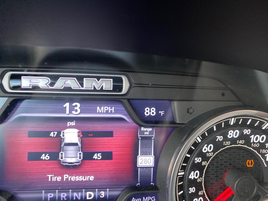

I will bring back an old thread, only one I could find with my issue but my truck is stock height and tires but tire sensors will go out randomly, it is usually the RF Passenger front tire, it will have the Icon light on for a day, or a couple of hours, once the right rear tire light came on as no reading, but it lasted for less than a day. It will go days without coming on, or it will go on and off throughout the day.
Every time I drive towards the dealer the light goes off, so that is my temporary fix, just drive towards the dealer. Does anyone else have a long term fix? The dealer did look at in during one of the recalls, but since the error light wasn't on they couldn't fix it. It is a 2019 Laramie CC, Ram Box, offload package, Sport.
I had this exact issue at less than 500 miles. My dealer 1st said the sensor needed to be reprogrammed, which did not work. So they ordered a replacement and no problems since. I now have just shy of 5k miles. And also my tpm light was never on when I took it in, they replaced it with no issues. Maybe take a photo next time it comes on if it’s an issue.

Sorry for bringing an old thread to life, but I am having this issue. no lift, save tire size. anyone figure out what the root cause is and what the fix is?
The TPMS sensors have a battery. Therefore they only last so long. 5-10 years is what research will show you. My right front sensor stopped working about a month ago so I went ahead and had all 4 replaced at a local tire shop. Because I also bought 2 tires from them they charged only me $140 for all 4. Included the sensors. The dealer wants $150 per sensor.
