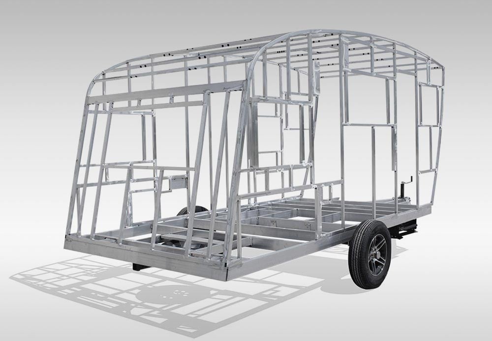

I've seen Jayco and others. And I'm not impressed with the build quality! I'm on the fence too. Maybe waiting also. Crazy world we live in!
We really wanted a Grand Design for the longest time, but inTech won us over with their build quality.
No issues with ours so far. I'm sure we'll have some things pop up, but structurally, it's as solid as anything I've looked at.
