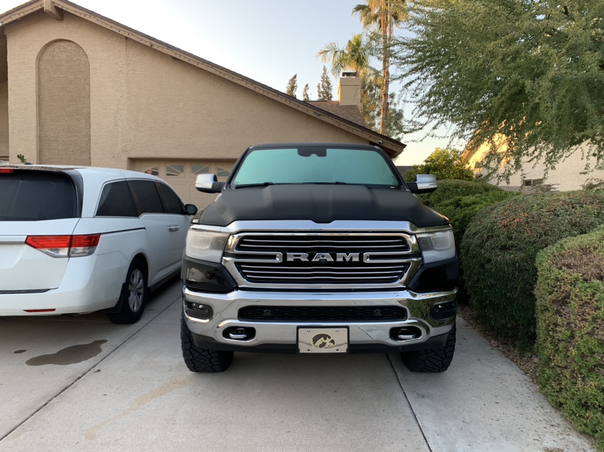

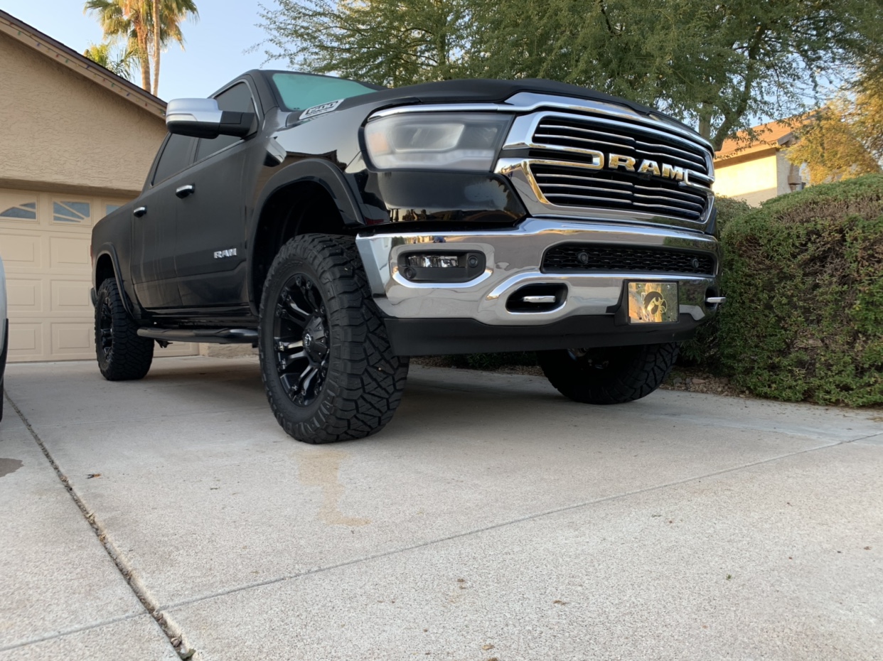

Did my tow hooks yesterday. As always this thread really helped along with the YouTube video. Pretty straight forward but the space is tight. Had to rake of the front wheel well liner as well to even be able to get at the bolt. Just take off the front 3 screws and loosen the 2 inside of the tire as they are slotted and you don’t need to take them all the way out. Probably pretty obvious if you do it in the daylight. Took some pictures this morning.

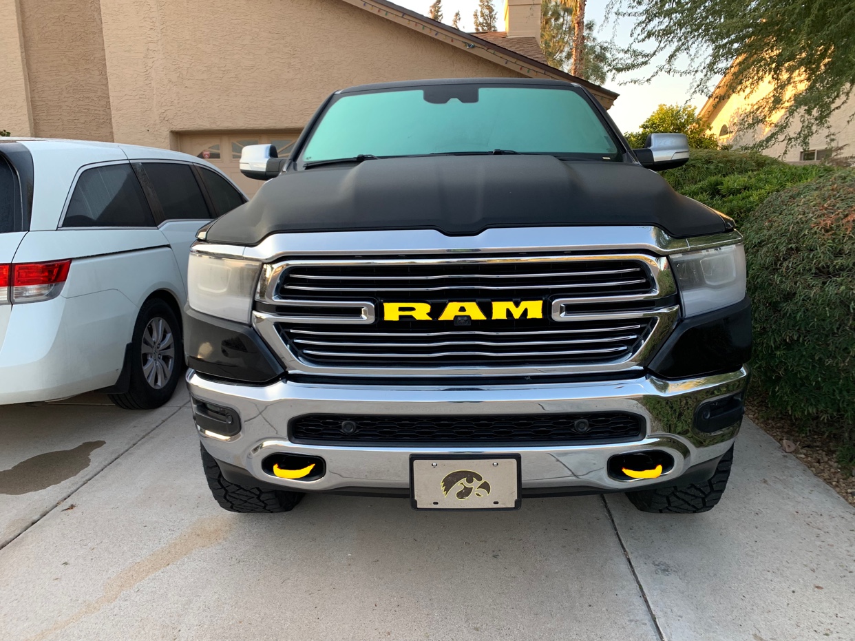

And a mock up of what I am thinking about doing to them.
Looks good. Go Hawkeyes! ;)
