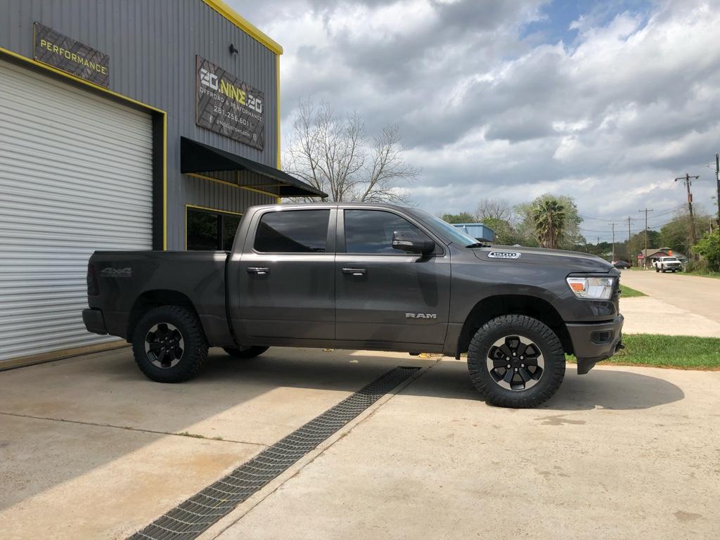

BTS w/ORP. 2 inch spacer in the front and 1 inch in the back. With stock 275/55r20s front wheel well is 39 1/4" to the ground, rear is 40 3/4". 35x12.5x20s getting installed in a couple of days.
I was planning to do the exact same lift on my BTS but with 34” tires. Do you have any photos of your truck with the 35s installed? Just curious how they look.
