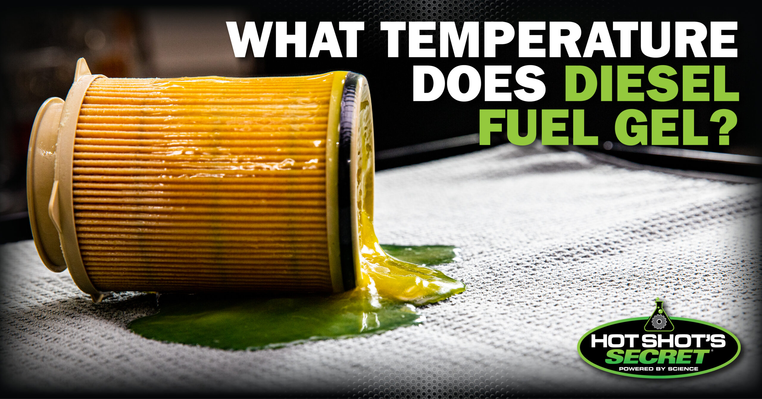

This is a partial quote from that 2019 article:
“...We used to own a towing company and unfortunately for our customers, we have seen plenty of gelling causing vehicles to not start in the winter.”
Diesel fuel, especially #2 Ultra Low Sulphur Diesel that is common to all services stations, will ‘gel’ as the paraffin in the diesel fuel starts to crystallize and freeze. With enough cold it will produce a solid wax-like substance that can clog the entire fuel system. It is similar to how a candle once it is lit warms the wax and the wax becomes a free-flowing liquid, then as it cools it becomes solid again. A similar process takes place when diesel fuel begins to crystalize during cold weather. When the weather is close to 10 to 15 degrees Fahrenheit*, gelling starts to occur and can clog the fuel system (*depending on the source and quality of fuel, gelling can occur as high as 20 degrees.”
(End of copied portion)
