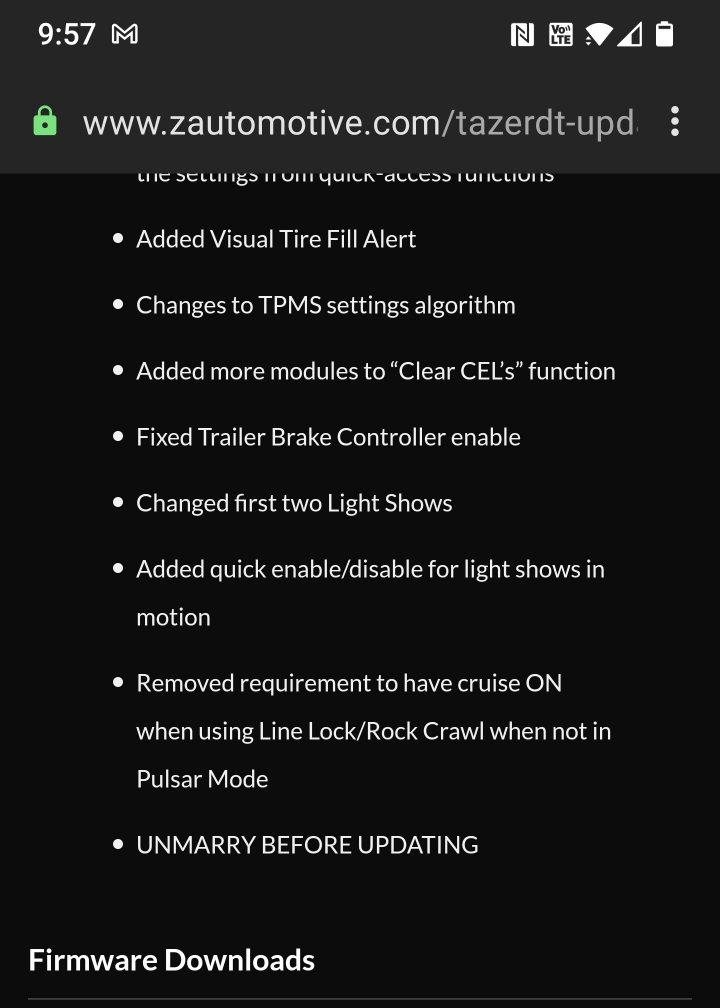

Unmarried (what a pain this was trying to get through the screens) and awaiting reply from support. I texted them and emailed them last week. Yet to hear anything.I would make sure to unmarry the unit before removing from the truck.

Tazer got back to me today stating the below:
"You're encountering a very rare glitch that we've only seen a few times. It doesn't actually affect how the Tazer works other than overriding the readout on the dashboard.
You can get around this by pulling fuse F44, located in the Internal Power Distribution Center (interior fuse box), which is behind the kick panel below the steering wheel. Removal of the kick panel is required to access the interior fuses.
That will keep the menu from being overwritten and you can replace the fuse when you're done."
This fuse runs the radio system. Their response leads me to believe I need to pull the fuse anytime I want to use the lightshow, 0-60, or anything else "on the fly". Does this seem like a correct assumption?
They are going to recommend it to cover their *** in case something doesn't work rightOn some updates they recommend to unmarry prior to update.
Of course thanks to lawyers but actually they don't recommend on all downloads but mostThey are going to recommend it to cover their *** in case something doesn't work right
