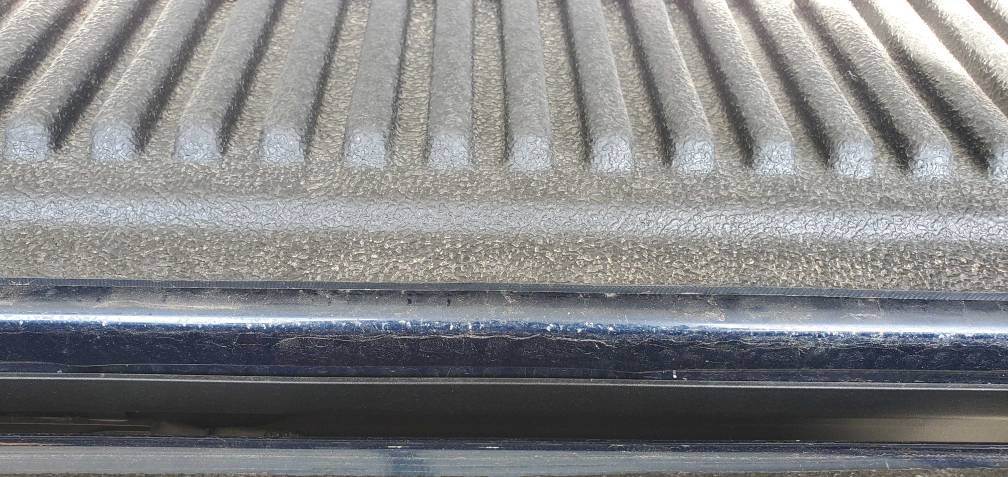

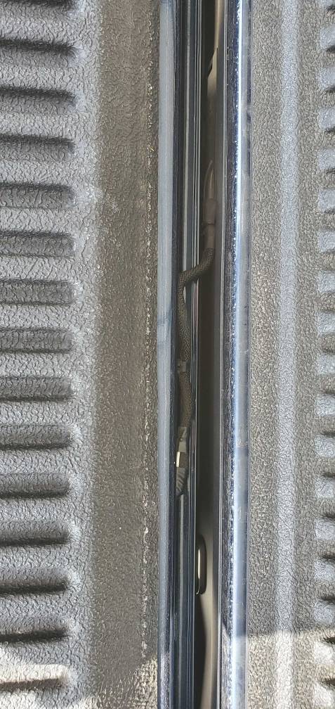

I'm gonna post these here and on the VLEDs thread- I just solved the issue, at least for the VLEDs light. Took a thin piece of foam gasket that I had lying around from my tonneau cover and cut a piece that was 11" long by 0.25" wide. Wiped the VLEDs light real good with an alcohol wipe on top and stuck the strip on it. Worked perfectly! Now the tailgate rests on the gasket instead of the plastic on the light. I'm 99% sure this will at least solve any concerns of damaging the paint on the tailgate. The gasket isn't noticeable unless you get right up to it and look at it. Standing back at any type of distance it just blends in.

The stock drop in bed liner also does this to the inner tailgate. Which I found out too late to do anything about it.
You think If i put that same foam gasket along the edge of the liner it would fix that issue ? I've got a whole thing of it.
tuner1129
Dec 15, 2018
40
9
Yes, it will definitely help bot cause the clear coat to start peeling off. I'm not sure how I am going to fix that since the clear coat chipped off. If you can get a bit wider and flatter gasket it will most definitely fix it. I rarely use my tailgate so that is friction of just daily driving.
