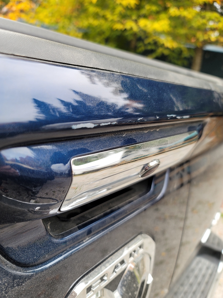

I have a limited, warning come all the time and I can't pull it open most of the time it comes on. Really have to close it like a truck either way I open it. The barn door way touches ever so slightly when closing and is leaving a mark on the paint as well...
