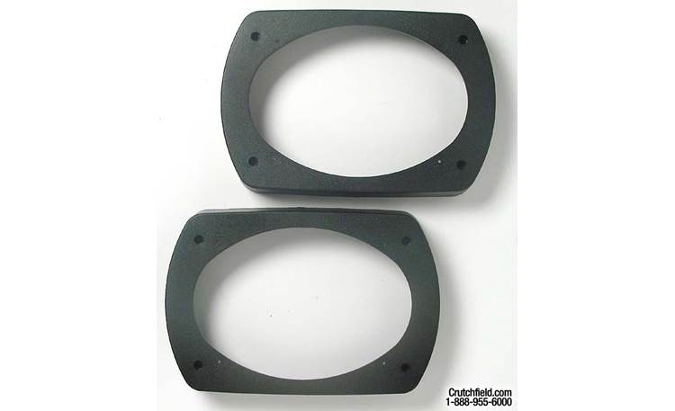

Mounting depth is > 3.25" for the front speakers, and there is room for up to a 3/4" front-mounted spacer without hitting the inside of the door panel. Plenty of room.

My numbers are based on the amount of space/clearance in front of the window with it rolled down. I have 8's in all my doors, there is plenty of room in there for pretty much any 6x9 you could imagine - especially if you add a front spacer/adapter. (y)

It was a lot easier than I was expecting - the panel material is a soft fiber plastic and easy to cut. There is a lot of room and front clearance, I used 1/2" plates with no problems. Worst part by far was threading new speaker wire through.
