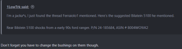

The other option, Bilstein 5100 and have to search for the FORD RANGER Part# for rear shocks people are using. That way all 4 corners are 5100's silver. Also depends how low.
I picked up a set of the ranger shocks for the rear…. May or may not stick with them once I lower, but wanted to have something that would ‘fit’ to start
