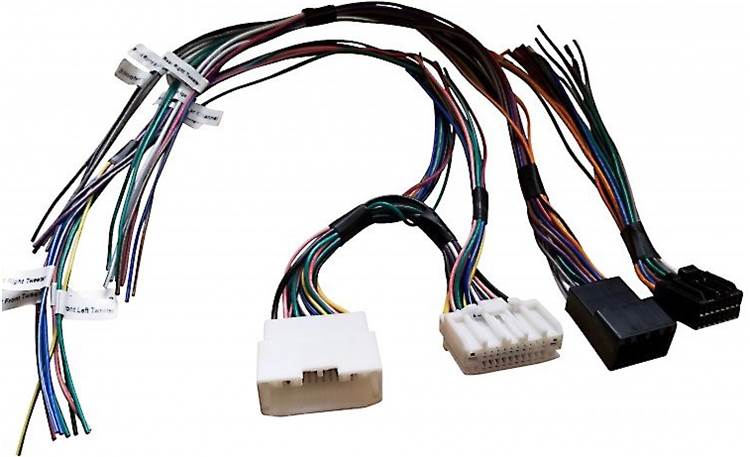

If you are going to do it yourself you can add the harness below inline to your anc underneath your drivers seat. Then you can add a Loc/dsp, amp(s) and sub(s). Done. Note though that your loc/dsp must present a load to the head unit otherwise it won’t send audio. If your loc/dsp doesn’t have that feature built in you can add 5W 47ohm resistors to the + inputs into your loc/dsp. I will also include a link for an awesome and reasonable dsp below that has the load feature built in. All you will need besides the harness and dsp below are amps and subs of your choice.

Pac harness

Pac harness
