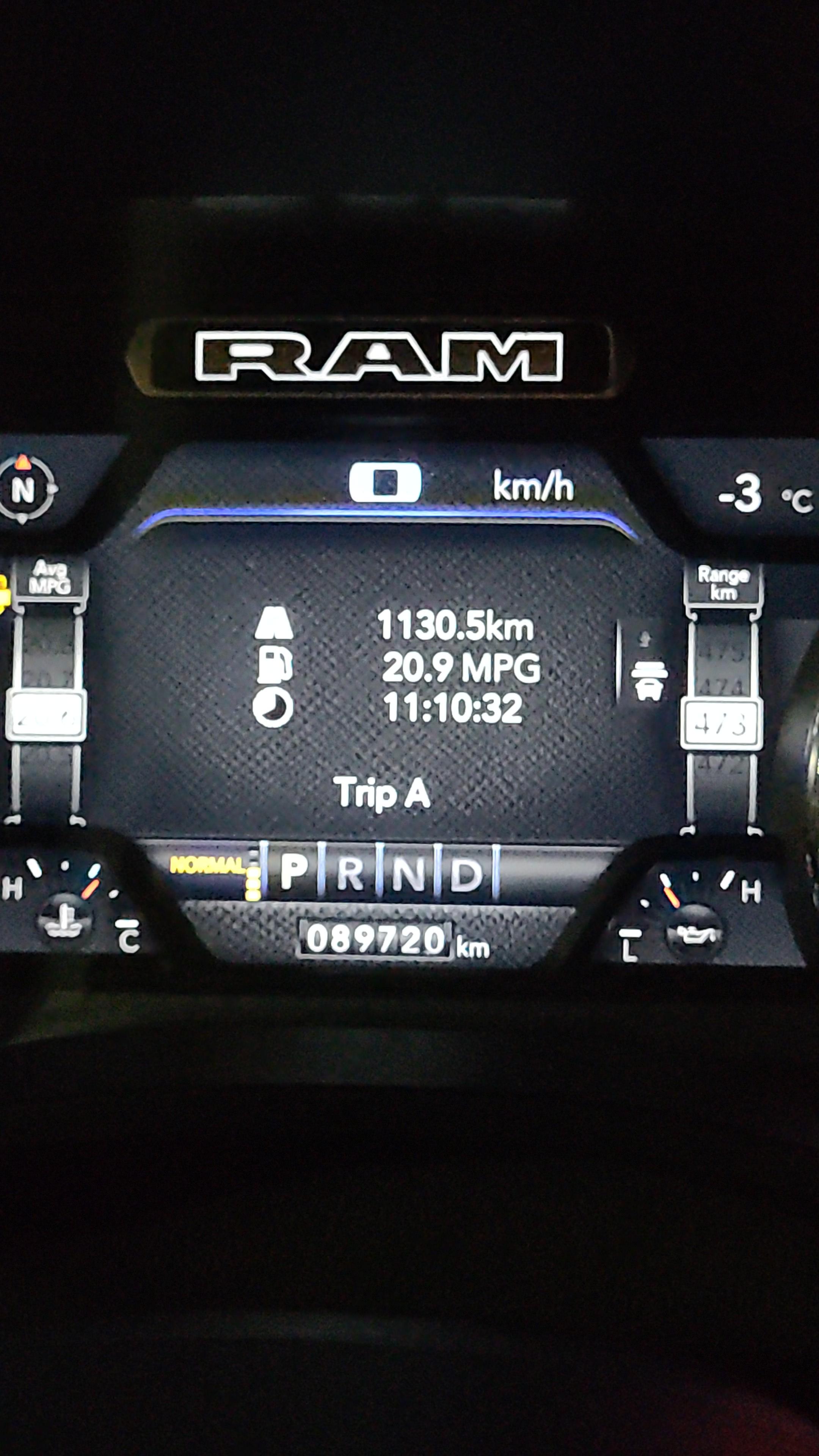

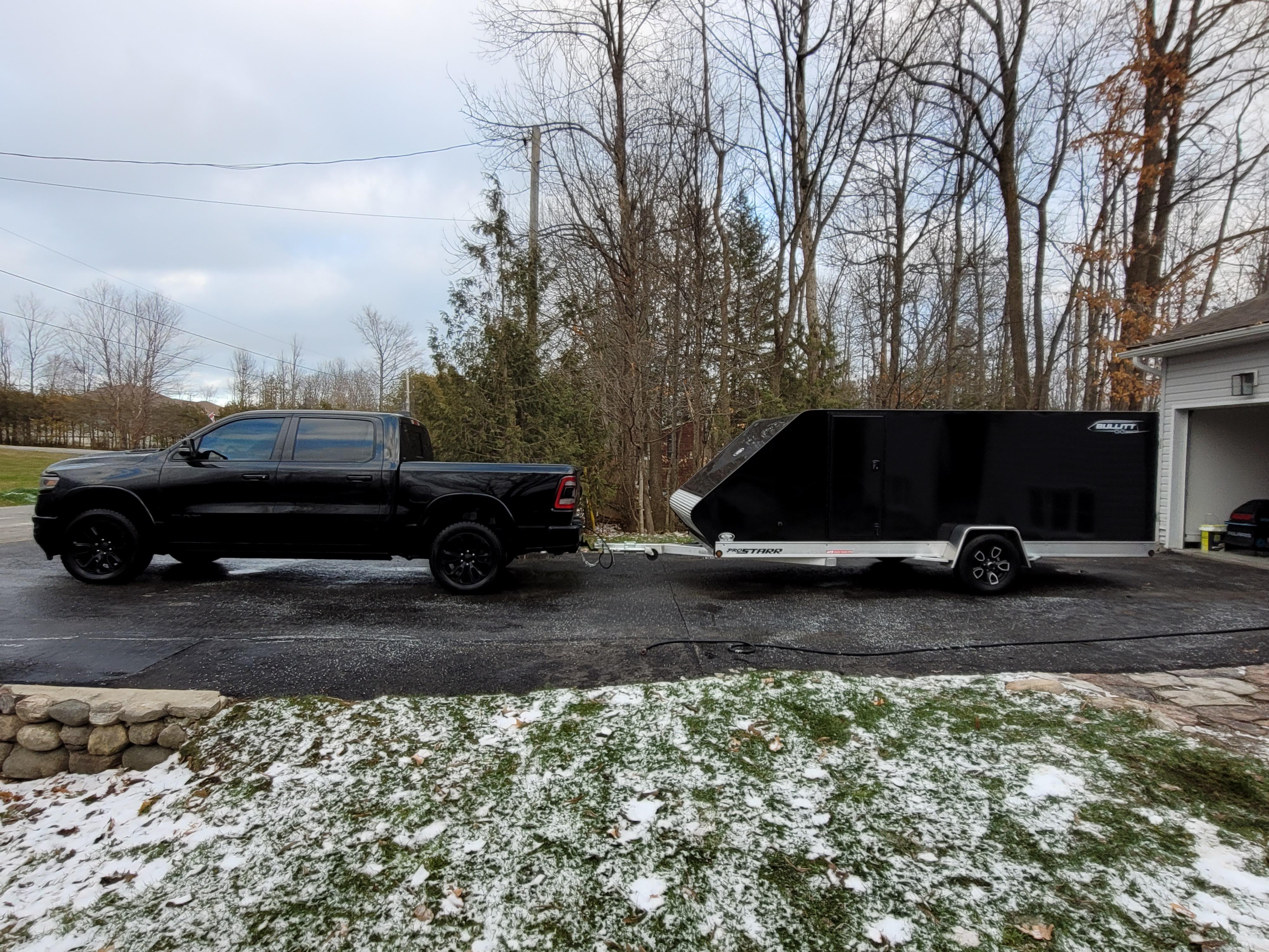

Just drove 1130km (700 miles) towing my 7x16 enclosed snowmobile trailer. With two snowmobiles it's probably around 2500lbs or so. Cruise control set at 112km/hr (70mph) with tow haul on. Truck stayed in 8th gear and towed like a dream.
Ecodiesel rocks.

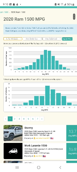

Looking at this, the 5.7L e-Torque (the default engine choice on my Limited) at 16 MPGs 2021 Ram 1500 MPG - Actual MPG from 154 2021 Ram 1500 owners

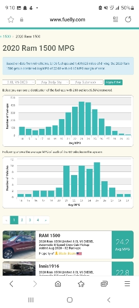

and this, the diesel overall spec where I’m in the mean (23 MPG) 2021 Ram 1500 MPG - Actual MPG from 101 2021 Ram 1500 owners
I definitely want to compare total cost over 30,000 miles at my MPG against the mean for those that didn’t pay $3200 for a diesel.
My average price per gallon of diesel over 2 years and 30K miles is $4.15 a gallon. Mid-grade is siting around $3.50 at the moment and it has tracked either on par with Diesel or 50-75 cents below it depending on where we were in pandemic hell in fuel prices.
30,000 miles @ 16 MPG @ $3.50 a gallon = $6562 spent on fuel
30,000 miles at 23 MPG @ 4.15 a gallon = $5411 spent on fuel
So I’ve saved $1151 USD in fuel so far at average prices. Fuel is dynamic so I won’t know for a few years what ends up being the 5 year average on both 89 octane and highway diesel but at today’s figures , my $1151 savings took 21 months. To save $3200 (price of the motor upgrade), it would take me 59 months or just under 5 years just to get back what I spent on the ED motor.
