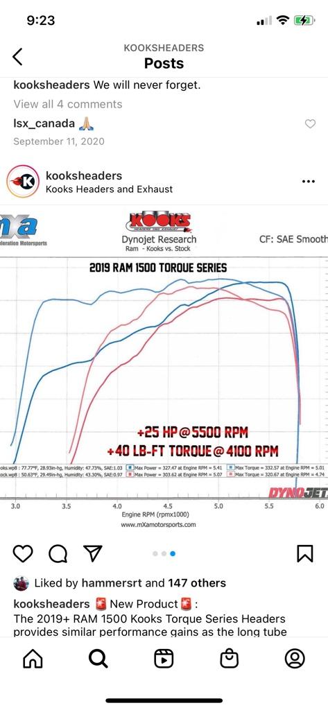

Kooks has a set of shorty headers for our trucks.
$1,400 MSRP though...
Bolts up to existing y-pipe. They say +25 hp and +40 torque gains.
I don’t think it’s a hard install but it’s an exhausting one (no pun intended). Lots of goofy angles required to get access to every bolt.
I’d be really curious if shorties really are capable of the below gains without a tune.
Yeah big $$$ and i would love to know if they are seeing those numbers with or without a tune.
I imagine those gains are "part of a complete breakfast"... headers combined with CAI, tune, etc could net you that combined increase
That’s what afe told me also. Everything stock except headers. I agree gains, but that’s a lot for just shorties..... hell even LTs
