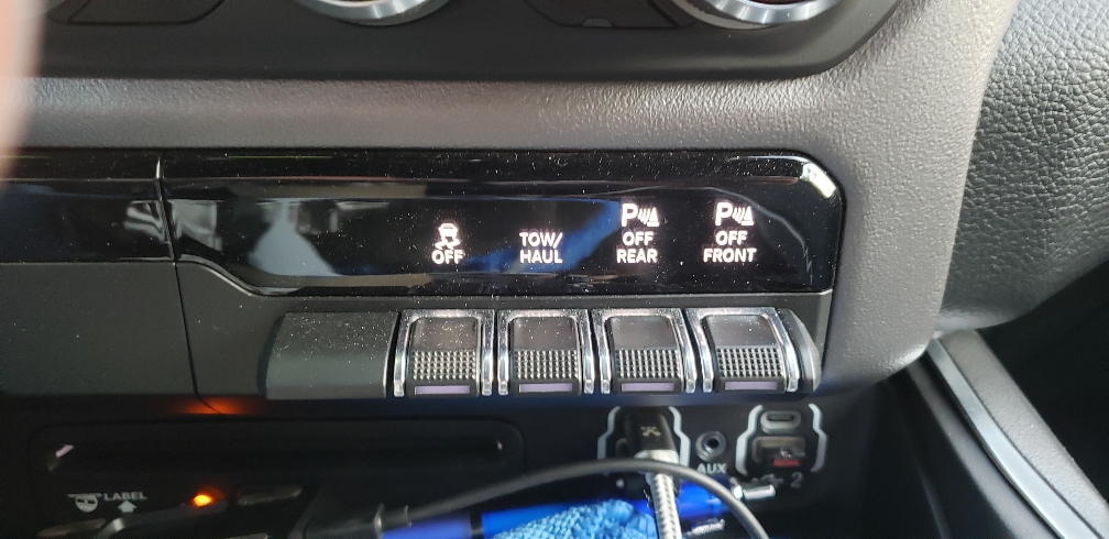

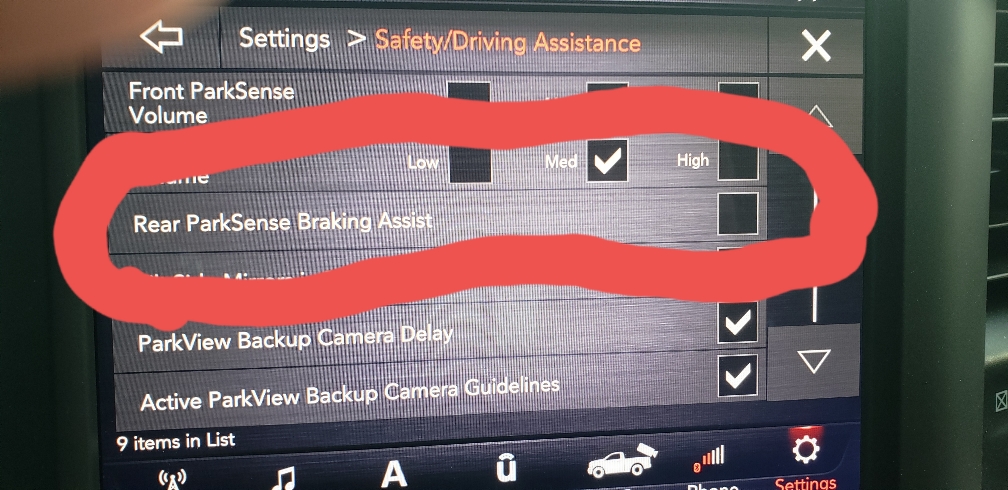

Button on the dash. You can go into the settings and just turn off the braking so the sensors still warn you.
First pick is where you turn the sensors off. Second pic is where you turn the braking off.
