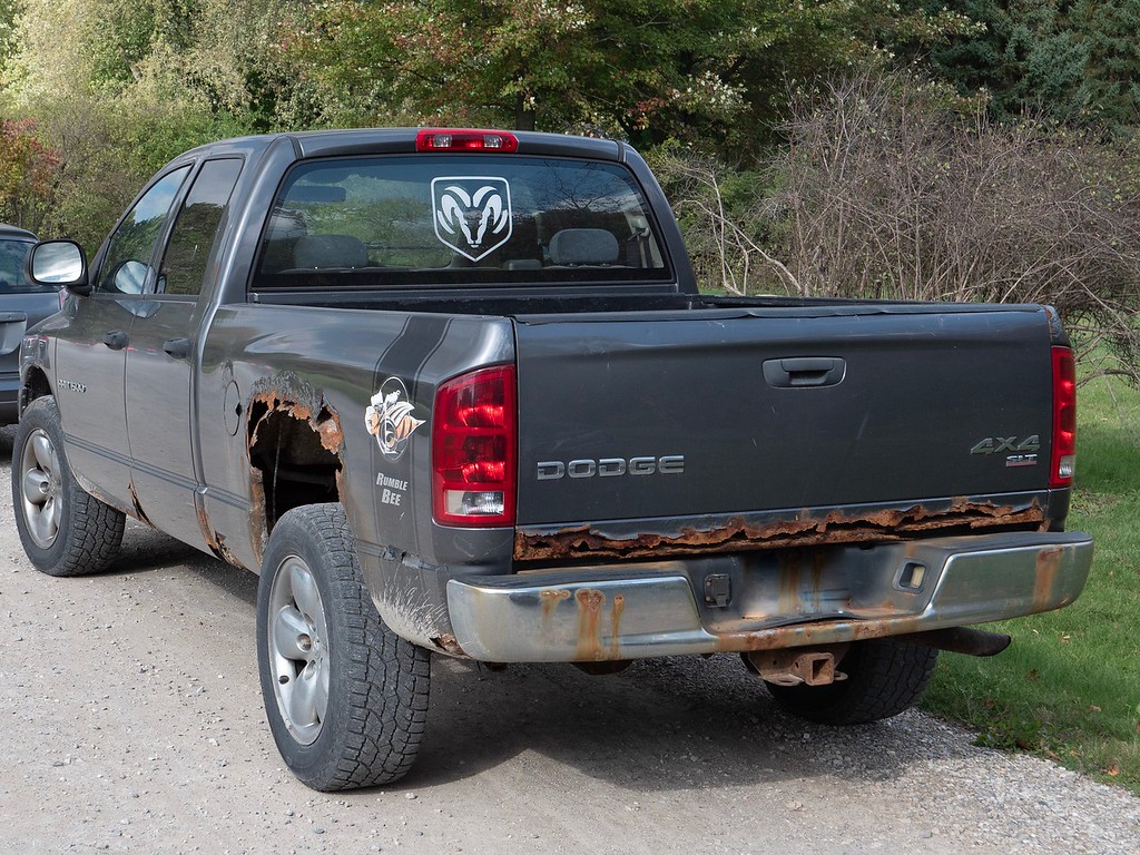

Too early to tell. 3rd gens were known for their rust issues, due to design of the rear fenders (why a lot of guys recommend rear wheel liners, to keep stuff from flinging up there in the first place). I had the rear fender rust, rust along the rockers and cab corners, and rust starting along the bottom of my tailgate.
I've kept a close eye on 4th gens, to determine if ram has made improvements. I believe they have, as i have yet to see a 4th gen (back to 2009) with rust above the rear wheels. Many for 4th gens were optioned with wheel liners than 3rd gens. The only rust i've seen on a 4th gen was all along the rocker panels. He had no front mud flaps or running boards, and drove on gravel a lot based on the dust constantly in his wheels. Read some issues with rust in the front corners of the hood, so keeping an eye on that.
I have seen rust in the rear fenders of some GM vehicles built after 2009, and rust in the cab corners of and rear fenders of 2009 or newer Fords, so anecdotally i believe Ram 4th gen and newer are no more prone to rust then any other (save 2015 or newer F150s)
