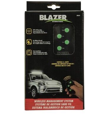

If you plan on running multiple accessories in the future, might as well install something like the Trigger 6 shooter.
I'll save you some searching.
I had the same train of thought. Ordered set of 3 homelink garage door control modules with remotes, each controlling 3 modules. Hooked them up to a 12vdc power supply and programed the remotes for 1st push on, 2nd push off. Next step was to take one of the remotes to the truck and program the garage door switches on the visor. Instructions are in the truck user guide. Done. Now I have 3 remote controlled relays that I can interface to outdoor lighting, or truck add ons.
I used this and the install couldn’t be easier!
I’ve had it for 1 year and some change and it’s been flawless.
