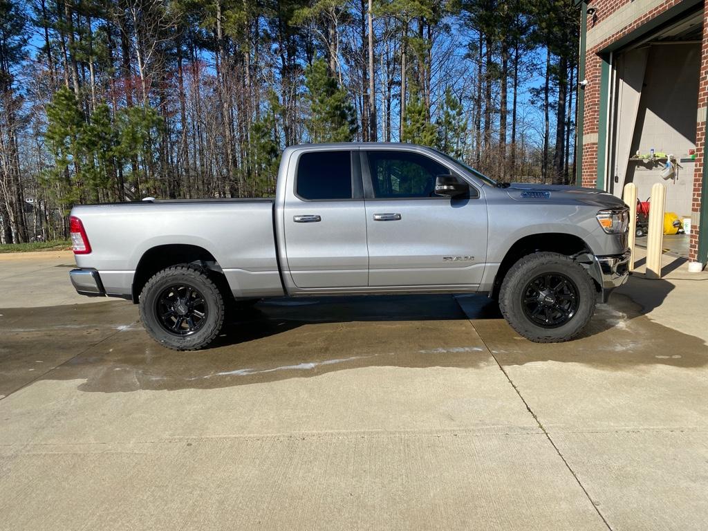

I have the 3.5” Readylift and just put on some BMF Payback wheels. 22x10.5
No rubbing or trimming
