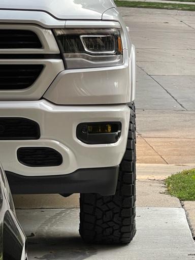

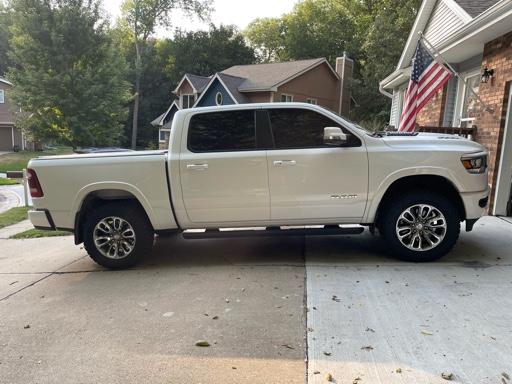

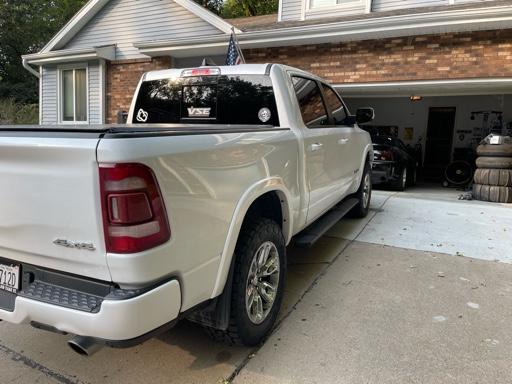

Here she sits. 2” M1 front. ORP Ram Box springs in rear for an inch. On 295/60R20 Toyo AT3 rubber. I do have a 1/4 spacer as well. Only bent the Mopar bracket for the front flaps a touch on the insides. Rides great!

Nice! I ended up going with the Bilstein 6112’s and 285/65/20’s on a 0 offset. Looks good!

Bilstein makes good stuff. I went RC to give them a go. I plan to do Carli. But after the HVAC replacement and such it wasn't happening and my tires were toast haha. So far, Kit is great and no issues. Rides nice, Firmer and more sporty feeling. But not harsh. Some of that is being on a Load E tire...not at all uncomfortable though
