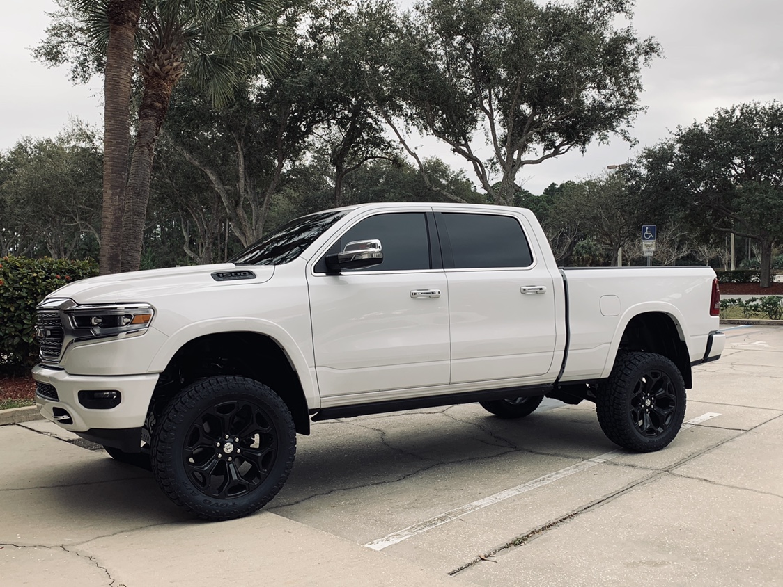

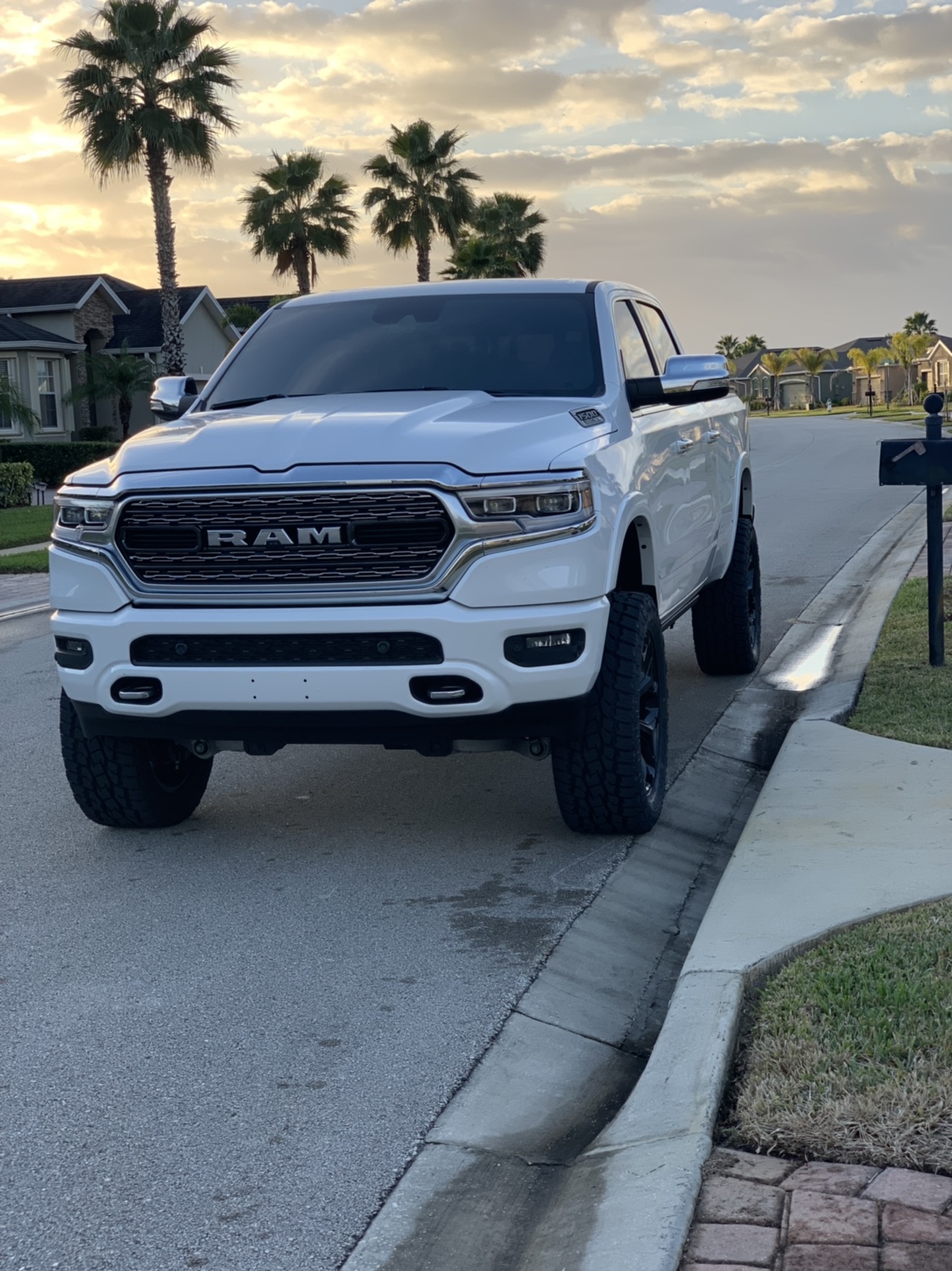

Rough Country 5" Lift Kit for Limited with Air Suspension. 20" wheels and 33" tires.
First few pics are normal height and last 3 are Off-road 2 height.
what offset on the wheels? Are they 12.50's?
Looks great. That's with 33x12.50s? Doesn't look bad at all. I was afraid the tires would look too small. Have been debating if I wanted to do the 6" lift or not because I have the 3.21 gears and have been worried about 35s.

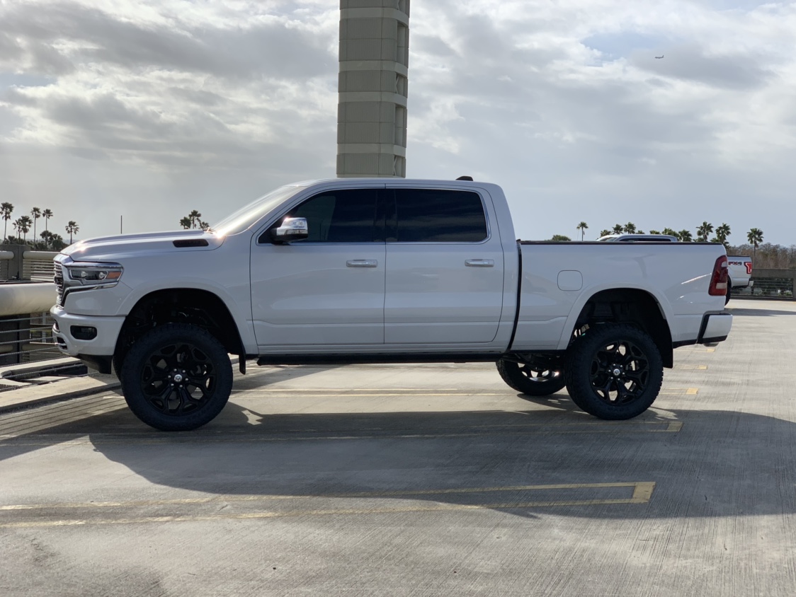

I finally got my lift installed. 5 1/2” Rough Country on my limited with Air Suspension.
Sorry for the ****ty pictures, I need to get some better ones soon.
Hey Mate your truck looks awesome. How does the ride and handling feel now ? Does the sidestep drop down enough to get in comfortably ? Also did you have the off road package too ? Thanks in advance
Yea guys... the suspension is essentially unchanged. It’s functions exactly as it did before. Just taller.
It will ride mostly the same, as not much as changed. The largest factor in that is wheel and tire combos. The More aggressive, the worse the ride (typically).
Did you powercoat the wheels? I’d like to put some on my big horn but in black.
