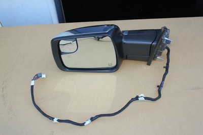

I found these power fold towing mirrors on Boost Auto Parts
I just got the Door Modules, Door Switch, OBD Genie, and the Boost Auto Mirrors. They installed fairly easy, and programming was simple. Everything has worked so far (Minus Auto-Dim/Memory, as those options are not available with these mirrors), and I'll check back if anything ends up not working going forward.
I reached out to Boost and they told me the package in your link is not intended for a 1500 that had non-power fold mirrors installed from the factory. Did you buy the door modules and door switch separate from the Boost kit to make the kit work properly? If so, could you share links to those too? Thanks!
