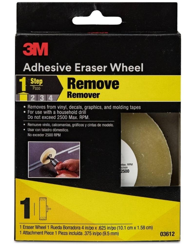

Just did this on mine the other day, have a big blister on my thumb from removing the bulk of the adhesive. If you haven’t done it yet I highly recommend buying a 3M pinstripe eraser wheel. Would’ve been well worth the $45. But if you don’t want to spend it I got it done with fishing line and goo gone. The Laramie badge on the tailgate was by far the hardest one.

Konakui
Aug 30, 2020
2
I used one of these to remove the chrome "4x4" on the tailgate and "Ram" on the doors. Used a fishing string to pull the letters off and the wheel on the adhesive. Came off clean. Detailers use this to remove pinstripe and prep cars for wraps, detail, etc.
