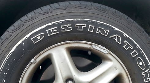

I don't think you can remove the white raised lettering on the Bridgestone Duelers can you? I'm not really a fan of the White lettering. But I really don't want to go out and buy a new set of tires just because of that. Any suggestions for blacking them out? Sharpie? Paint? Anything that may last?

As mentioned, best option is get them flipped to black side out at tire shop.
I don't think the white is easy to remove either, the white color is deep in the rubber from the tires I've seen, they won't just rub or brush out.

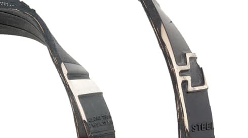

In case anyone's taking these wire wheel suggestions seriously :rolleyes:
The white lettering is actually a layer of white rubber all around the tire that is only exposed at the lettering. That's why when you rub a tire against a curb repeatedly the scuffs turn white. So taking a razor blade to it won't solve your problem. If anything, it'll make the white letters wider and uglier.

I figured that was the case, I know one of the recommend cleaning methods to clean the white lettering is either acetone or a wire brush. If it was just paint, that would actually remove the white lettering instead of cleaning it.
