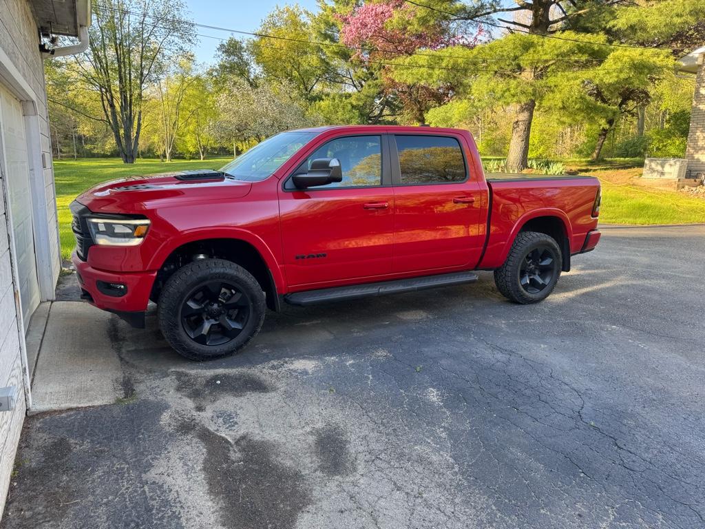

I got the readylift 1.5" leveling kit and couldn't be happier. Though the rear was lower after the install. I used alfaOBD to raise the rear and lower the front, but you could also use adjustable air links. The Readylift kit was very high quality and took me about 9hrs to install, taking my time.
I'd be happy to share more details if you want.
