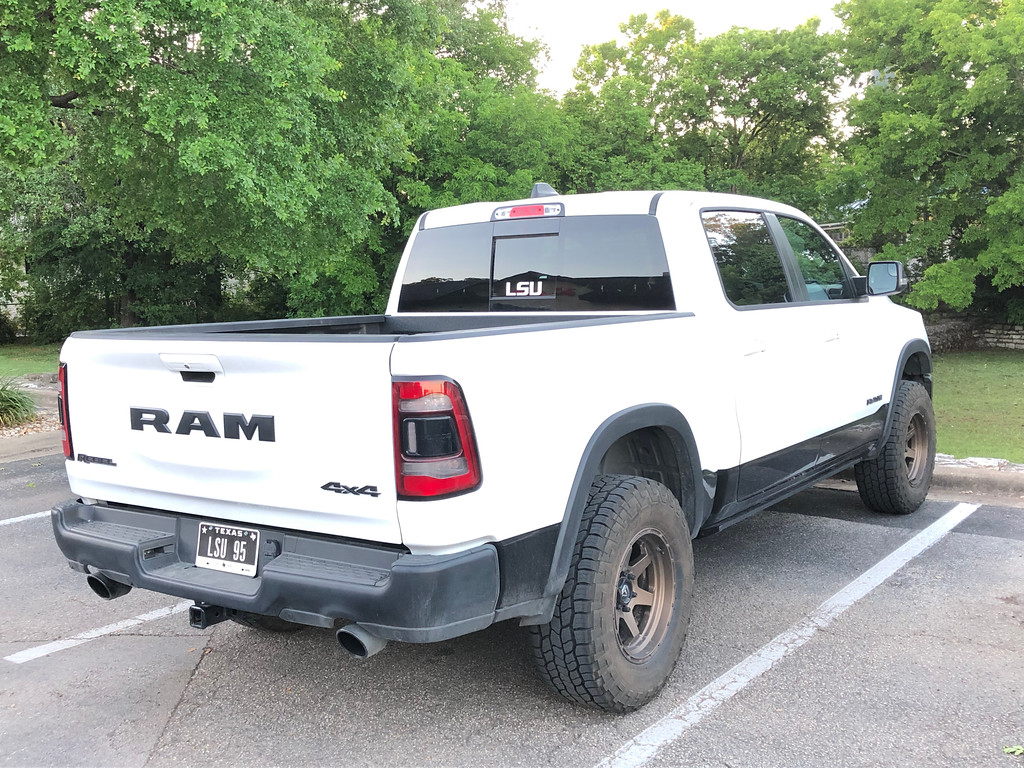

GARebel, thanks for the info! Comparing to my current setup, my Coopers are 61 lbs. (+7) and my Fuel wheels are 28 (-1). Puts my setup at 89 lbs, about 6 more than stock.
Well, I stripped it down to "normal truck" status. We'll see how it does on economy over the next couple weeks 'til I need to put the tent back on. :)
