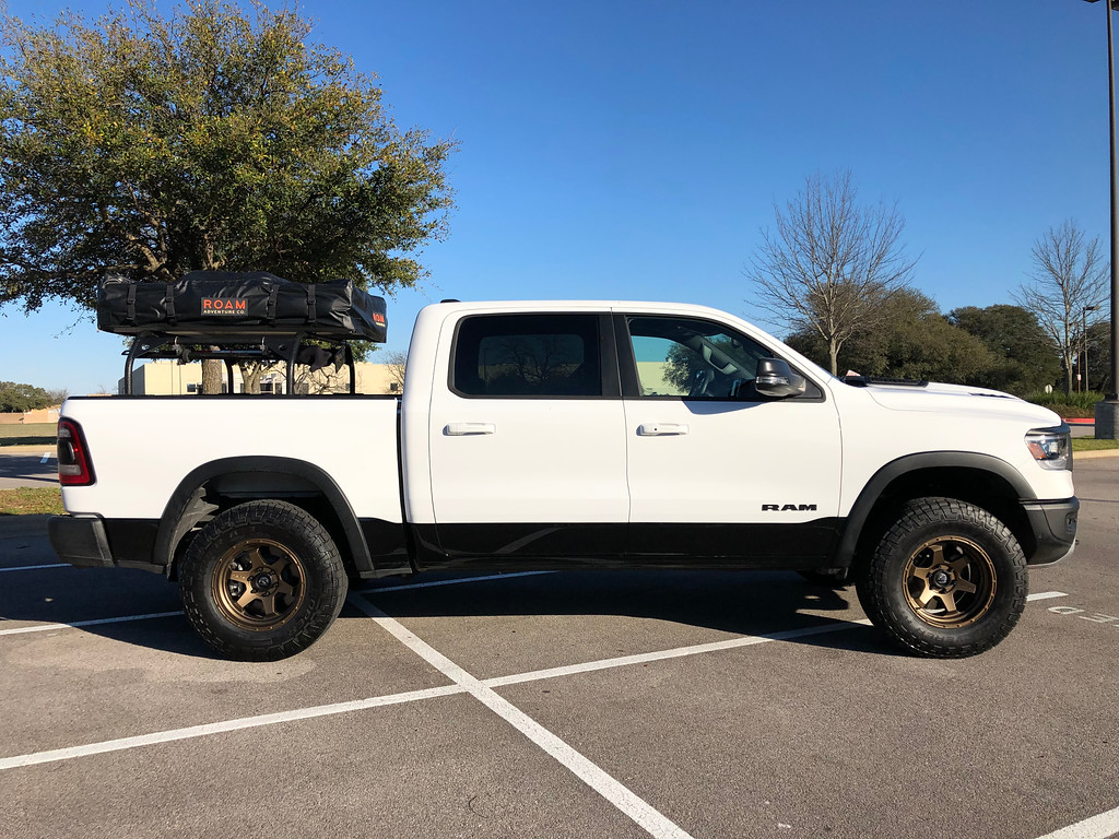

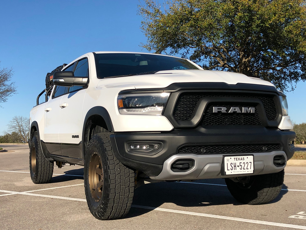

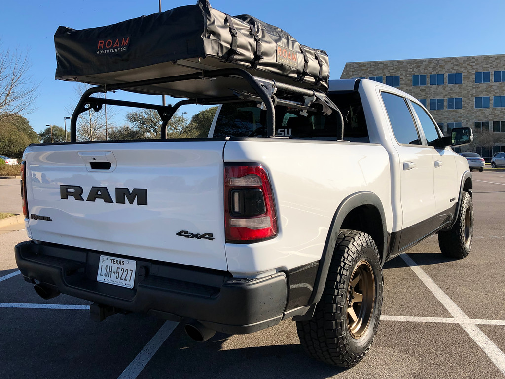

I sure did. So far I've only logged half a tank's worth of driving and it's about the same as before.....maybe a tick better. The tires are 1" taller: 295/70-18 Cooper AT3 XLTs and they have a much milder tread design than the Duratracs. They're the heavier E rated versions because I'll tow my Jeep with it. I also installed a 2.5" level with Motofab spacers and ReadyLift UCAs. Wheels are Fuel Shok in an 18x9 -12. It may seem contradictory for the guy concerned about mileage to do things that are clearly not going to help economy, but the plan all along for this truck was for it to be a capable, mild overland/tow rig/daily driver. I'm just trying to do what I can to meet those goals while also hopefully impacting the fuel economy with as little negative impact as possible. Hopefully over the coming weeks I'll have more data to share. Thus far, I feel confident that despite adding heavier/taller tires the economy hasn't gotten worse.....and that's saying something, if you ask me.
Here's some pics for those interested:
Thank you! I'm super jazzed with the way it came out. I was really concerned the bronze wheels would be a bit much, but now I'm so glad I opted for them instead of black.
Looks good! The two tone Rebels need some contrast from all black on wheels. I put Fuel Hardline 18"x9" on mine to add some bright milled accents, and turned white letters in on Duratracs'. Your wheel choice works really well with white/black paint. :cool: Just looked at your photos and the side view gave me a chuckle. The tree foliage lines up with your bed mounted tent and looks like its growing out of it.....haha. (There's your fuel economy problem......your bed bush has too much wind drag! ) :ROFLMAO:
Well, it's hardly scientific data, but thus far it seems that at worst my mileage is staying the same as it was before the lift/tire change. However, that's not including the fact that my speedo is now 3.3% pessimistic. I need to continue acquiring more data, but thus far I'm encouraged by what I'm seeing. I'll update more when I have more info. to share.

I am sure mileage will improve if you trim that big bush growing out of the truck bed....lmao....is it just me that finds the alignment of pic funny....:ROFLMAO:
LOL! Nope, Jhill pointed it out last week. :)
