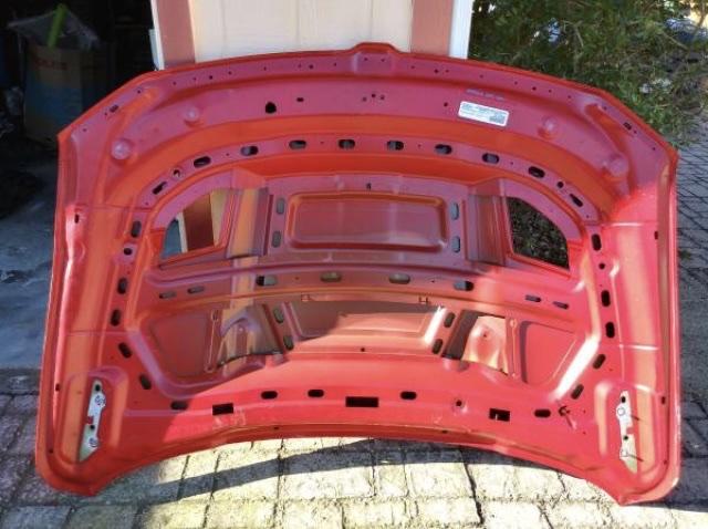

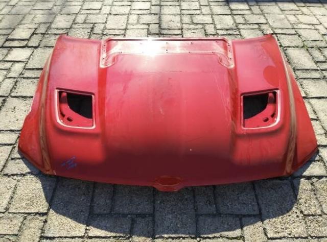

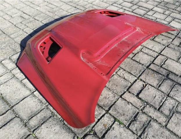

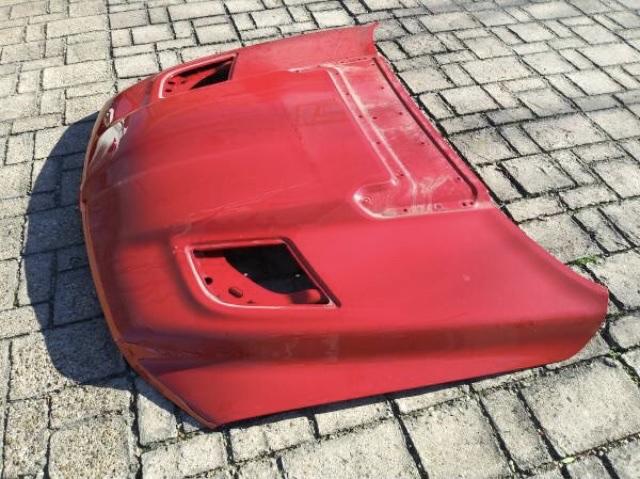

Here’s a few pics for reference. I pulled these from a Craigslist post awhile ago.
Still boggles my mind that FCA/Stellantis manufactures the hoods with functional cut outs only to complete them with sealed louvers.
This pic proves definitively that you can make the vents functional with a sharp knife and a Dremel. Good find.
