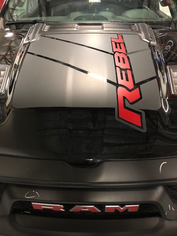

Installed the hood decal today. While applying it, it started to wrinkle at one spot and I didn't catch it so I pulled it up and heated it in that section, laid it down again and it looks fantastic except for a slight marring of the vinyl. Since it's at the leading edge, it actually looks like a stone could've hit it. Nobody will know at all.
Is that a OEM decal or aftermarket ?
It's an aftermarket decal. I ordered it from Auto Graphics Pro. I wanted good 3M vinyl and they state they have the good stuff.
Everything at the top went on just fine, but you will start getting "fingers" as you get to the bottom due to the multiple contours of the hood. I might have also had too much solution on my decal as it took quite a bit of effort to get the "fingers" to lay down. They kept popping back up because there was no stick to the decal.
I think I did pretty good for a 1st time with a large decal and being a perfectionist. More mistakes happen when you try to be perfect with automotive stuff.
