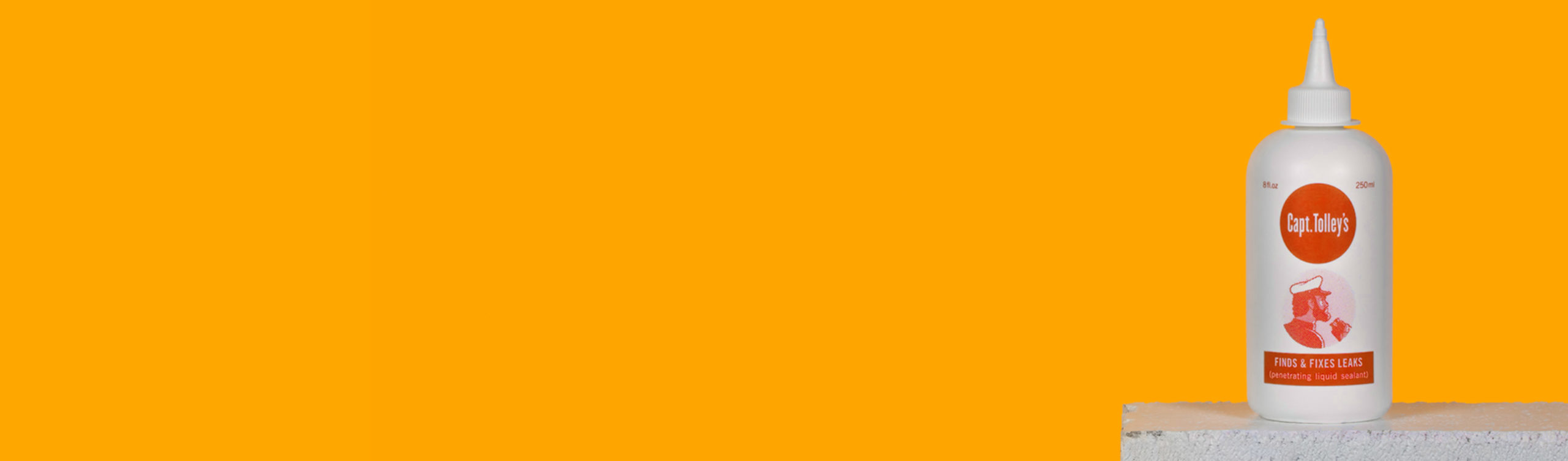

If you remove the trim you might be able to see exactly where the drip is coming from. In my case I could see water come from the glue seam itself. I was able to fix the leak from the inside of the cab using a product called Captain Tolley's that was developed for use in marine environments for sealing portholes, hatches, rivets, etc. It is very thin and uses capillary action to find cracks or voids. Just a couple drops of glue at the location of the water drip and it was pulled into whatever void was there. Could have douched the whole frame from the outside but wanted a more surgical repair instead of my normal chainsaw approach. I tried to repair the first window with silicone and that was an epic failure as the kids say. One of the best features of Captain Tolley's, besides having it fix my leaks, is being water based making any clean up a breeze.
I found Captain Tolleys. Thanks. For $13, definitely worth it. I'll give it a try. I still have s small leak I just can't find.
Awesome suggestion on the Capt Tolley’s. This may be exactly what I need.
I pulled back some of the trim and could not see any crack in the window frame all the way to the white retaining clip in the corner of the window. Looking at it outside from the top down. There is a small indentation at a body weld where there doesn’t appear be good contact with the window seal. Wonder if I can just squirt a bit of Capt Tolley’s in that from the outside. Anyone else have experience with using Capt Tolley’s before?
