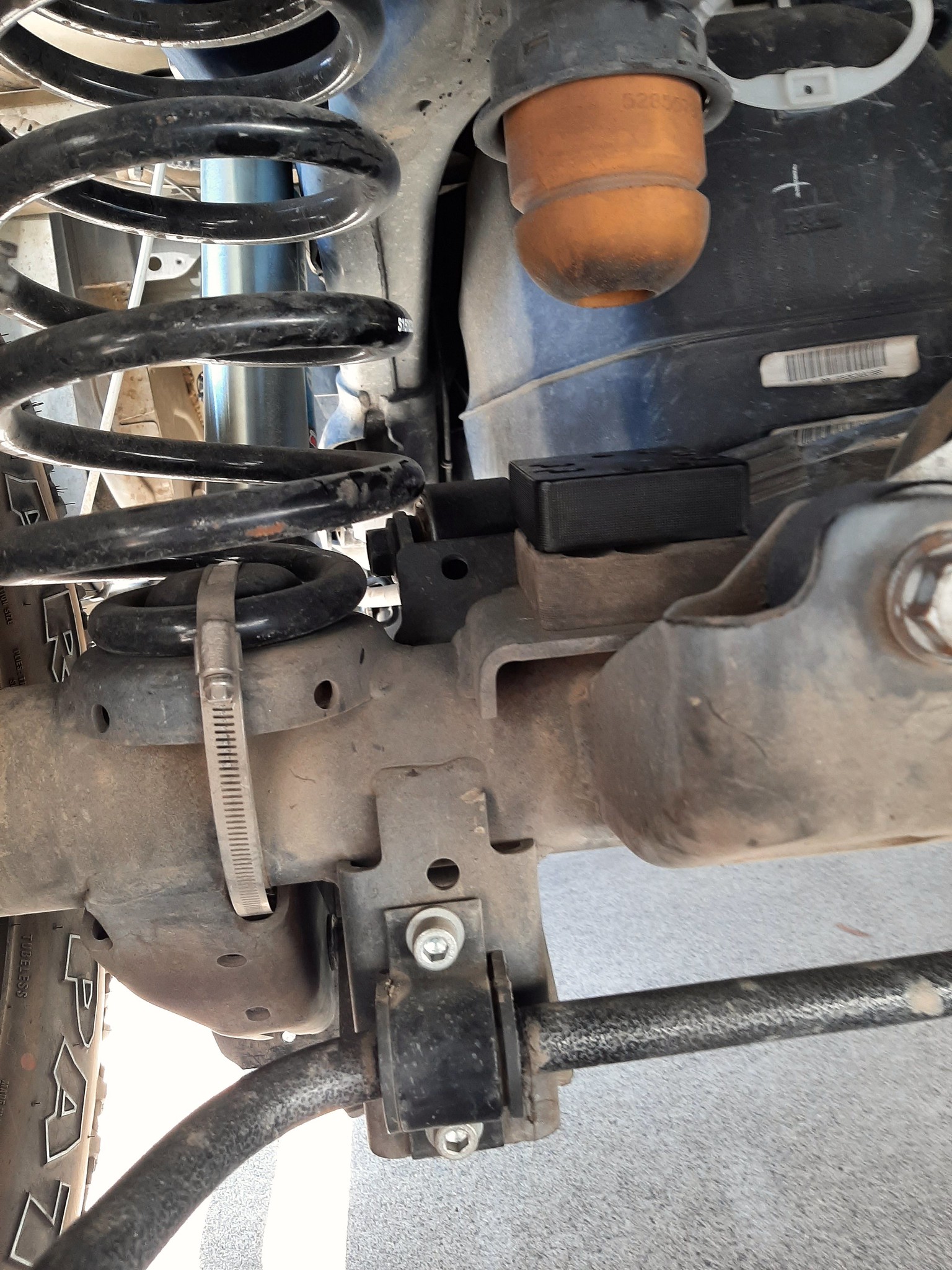

Does anyone have pictures of what they look like installed? have you had issues with them coming out( silly I know, I know guys that lost blocks back in the day)
Also any recommendations on brands with 1 to 1.5 inch spacers?
Goal - Install Bilsteins up front on max, a spacer in rear to give me a 1" above front, ready lift UCA if needed and then 35's keeping the stock blackout 20" rims if possible.
Any and all info is great 73537390_2711391362253265_629672201645195264_o.jpg

I've been trying to find a set 1.5 inch rear spacers that mount on top of the springs, the only ones I can find are bottom mount. Not sure I trust the bottom mount spacers ,they look kind of unstable.

The spacer isn't going anywhere, even at full droop. The spacer is the same shape as the factory spring perch so no issues with the spring moving.

Thanks, it's hard to see what I'm getting. Love to find part number for the mopar ones, the number I have is discontinued

Yeah, that looks better than the other ones I've seen. Who makes that one?
Motofab. Billet, solid fit. I would not use the poly spacers on a full sized pick up that gets loaded with gear. I have used poly on Jeeps and found the rears to compress/crush down some with just a couple of kids in back and a small amount of gear.

Do you notice much noise/squeaking with those spacers in the rear?
The spacer won't be going anywhere but how is the spring placed in the lower seat without the locator ? Is it just sitting on top of the spacer ? are you sure the spring won't move ? or perhaps it has its own locator as well ? (i don't see it the pic so i'd think it'll be ok if the spring can grab onto that)
The spring is supposed to hug the lower seat locator. You can also see my poor man's spring retainers, i don't need them with my setup but old habits never die so i just have them there just because :) prob something you could do if the spacer didn't have the spring locator.
2020-09-20_06-14-56 by RAM RSM, on Flickr
The spacer has a locator as well.
