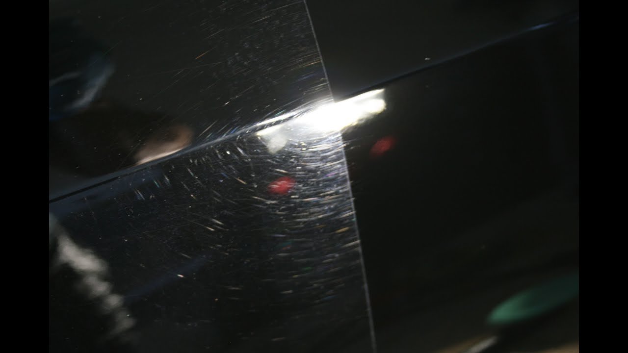

Can someone help explain what "paint correction" is? Is this something that the dealer's body shop has to do, or is this also done by a detailer before they apply the ceramic coating?
Paint correction simply means fixing the paint for defects. The dealers body shop can attempt this, but in many peoples experience, including mine recently, they will not do a good job and most likely will do more harm than good.
A good detailer will always suggest or include paint correction in their ceramic coating packages but it's not exclusive to doing coatings.
Paint correction is the general term for removing scratches, swirls, haze, oxidation or any other blemishes in the paint.
Important to note that depending on the vehicle, how thick the clear coat is and how bad the scratches are a paint correction will not remove ALL defects, but a good correction can remove 90% of them.
Picture is an example and the first hit on a Google search for before and after oaint correction.
Short explanation of steps is 1. Clean and wash the vehicle, 2. Strip all contaminants on the surface (including any previous wax products) done by various techniques, 3. Polish by a rotary or DA polisher to remove swirls, micro marring or light scratches, 3. Apply your choice sealant or wax. That is the short and basic explanation and there are some very good videos on youtube if you want to see all the various techniques employed. I do my own correction and protection. I use a griot's garage dual action (DA) polisher. I've been using Meguiar's polishes and waxes and car pro's sealants. Each individual has different preferences on products.
