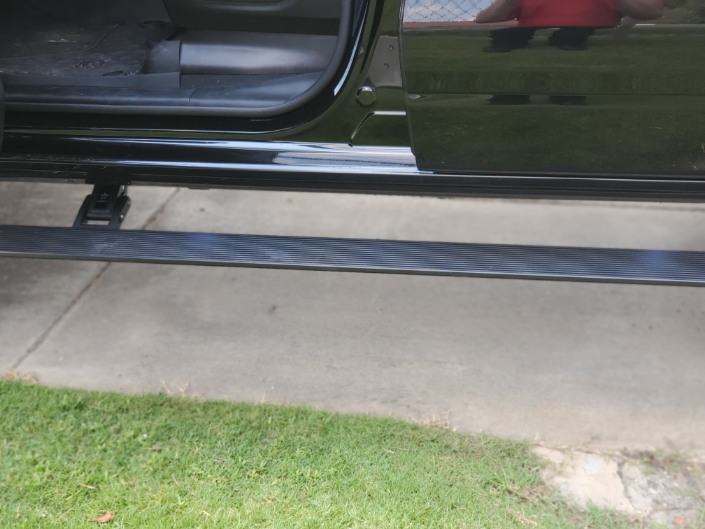

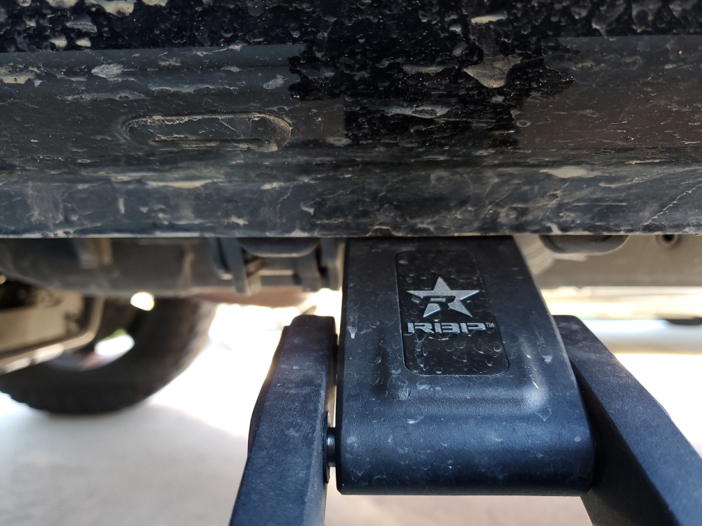

I have them.
Do these have different features than the stock power running boards? Some with additional puddle lights would be very cool especially if you could make them LED with different color choices that only come on when deployed or when you choose to have them turned on.

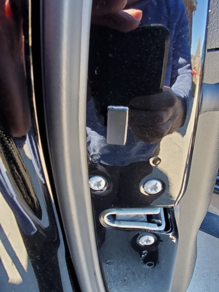

They come with 4 led pods one under each door. Imagine you could change them to any led that you prefer. Uses magnets to activate the bords. Simple install, only pain part is removing B post trim to run the wires.

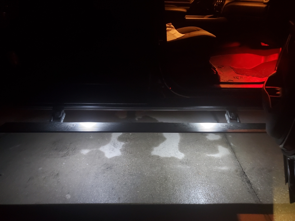

Any pictures of the lights on and how they operate (When deployed only)?
Lights come on when deployed. I will have to take some when it gets dark.
Looks very clean, what about the magnets at all 4 doors ? All good quality ?

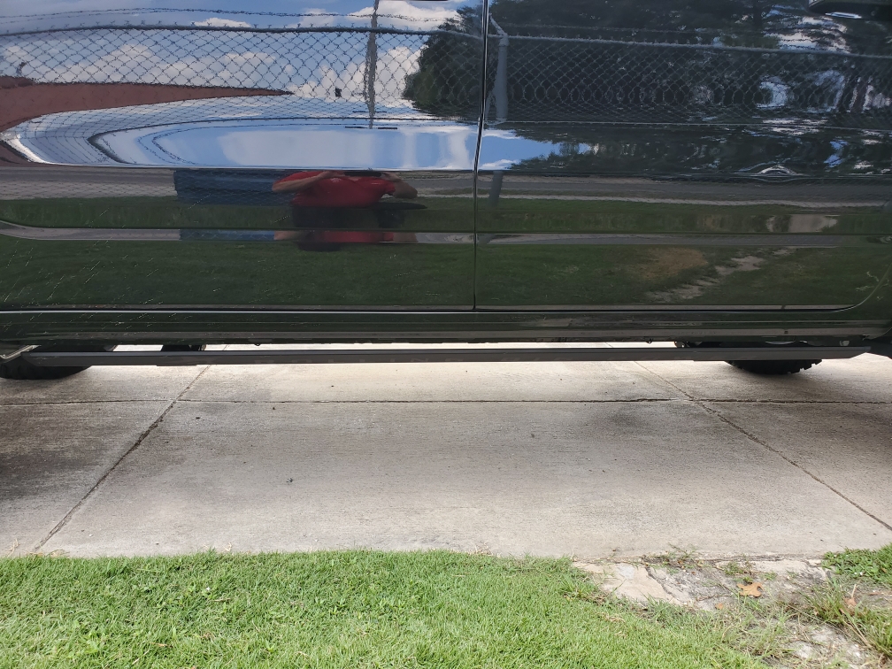

When they are in the stowed position, can you adjust that gap between the boards and the truck. That gap in the second picture looks kinda funky.
Ypu can adjust the stowed position, I lowered them a bit. The arms on the motor was hitting the pinch seam. I also have 6" lift.
I really like the great visibility the lights give to step in or out. I think I am going to install some leds with the OEM power running boards. Has anyone done this and if so is there power that can be tapped into on the stock power running boards?
