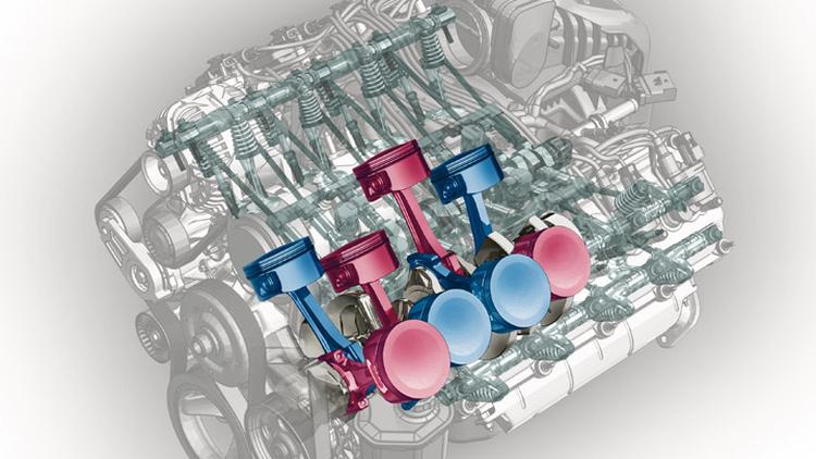

Here is an update. Some parts are on B/O and the repairs are not all complete so I don't want to say too much yet. What i can do is inform you of something i learned from my dealer. When they replace the lifters in your hemi, RAM DOES NOT CHANGE YOUR OIL!!! I asked them and was told no. I asked 2 people from the dealer to confirm this. I paid them to change it! I was also told the MDS is the cause of the lifter and cam failures. The MDS shuts off the cylinders which lets the vibration rotate the lifters of the deactivated cylinders. Im not really sure how it all works but thats what the advisor told me the area engineer told him, he also said its a VERY common issue. I first brought the truck in for the tick and was told it was the exhaust bolts broken, 5 each side. They replaced but tick was still there along with a rough idle. Now new lifters are needed.
This is false, it can happen but isn't why they fail. The lifters have guided/retainers that prevent rotation in the bore.

bigdodge
Happy Ram Owner
Aug 25, 2021
4,126
2,622
maybe this will help explain how it works
one reason I always shut mine off
