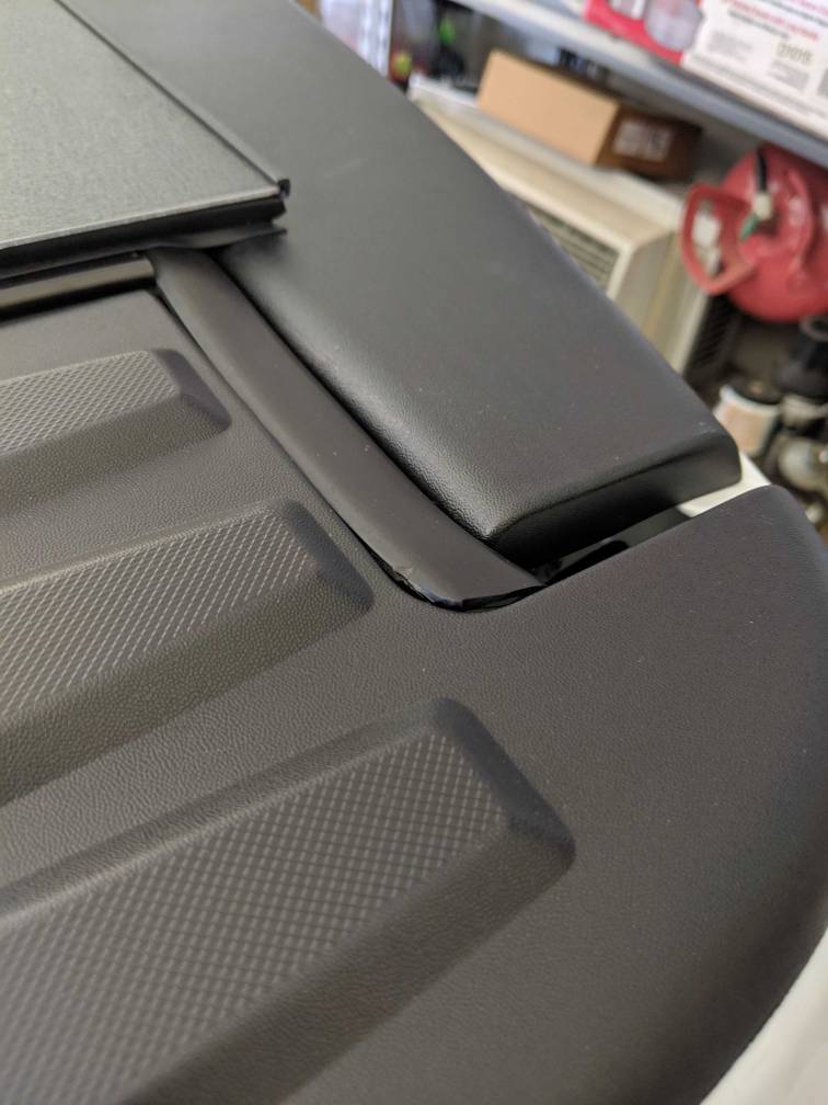

I just cut them to fit the curves in the corners. Not perfect, but good enough

Going through the carwash, I probably get a less than a teaspoon in both corners total. The bed itself remains dry

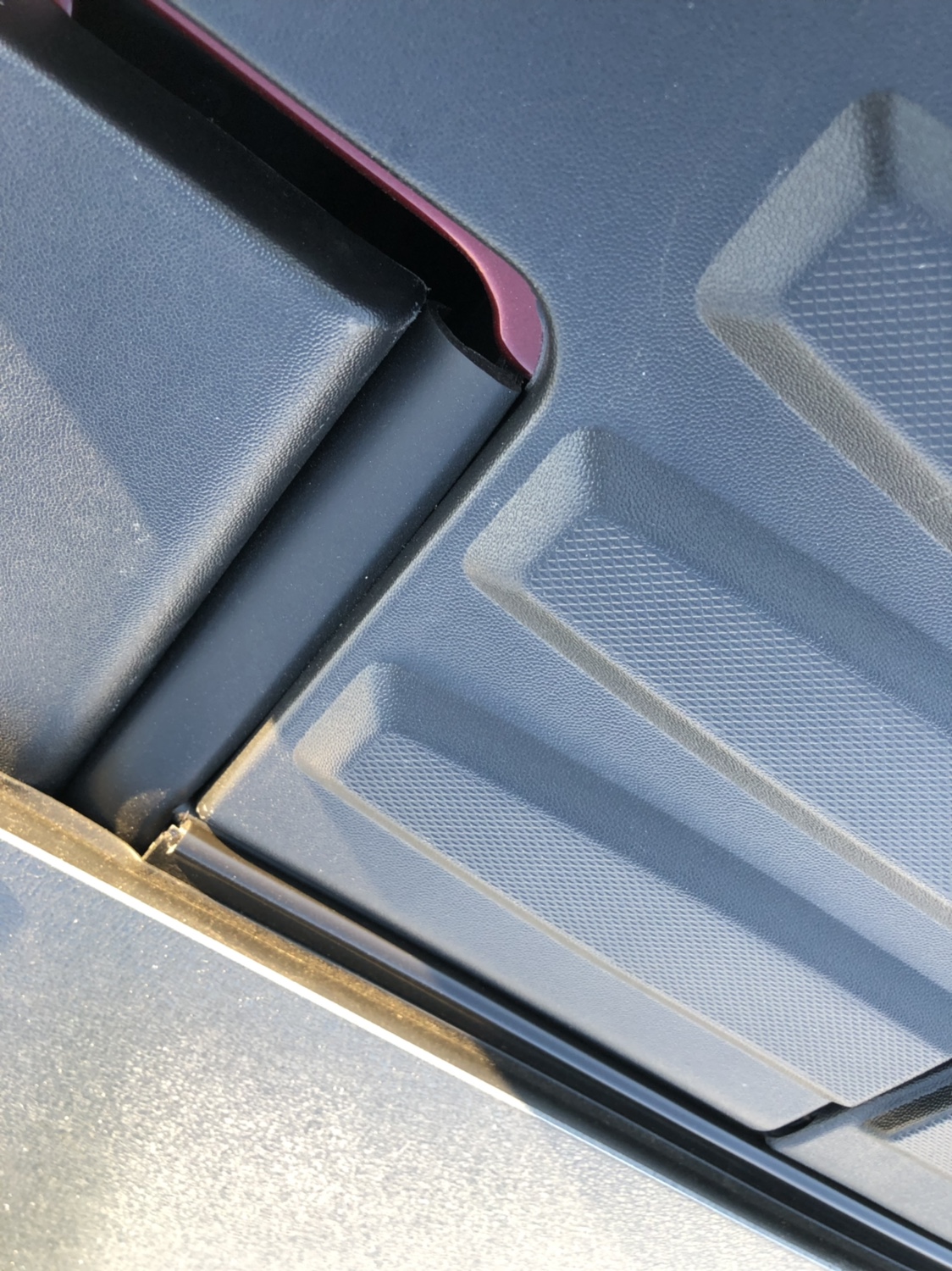

I too received the drawing above but in the absence of any actual instructions I thought it was a rain channel, and installed it like this. And what's that curvature about?

Get mine installed, looks like this seal perfectly filled horizontally gap, but still some other gaps between the tailgate and sidewall, since it’s summer, I will carry this worry to winter season to resolve it, lol
