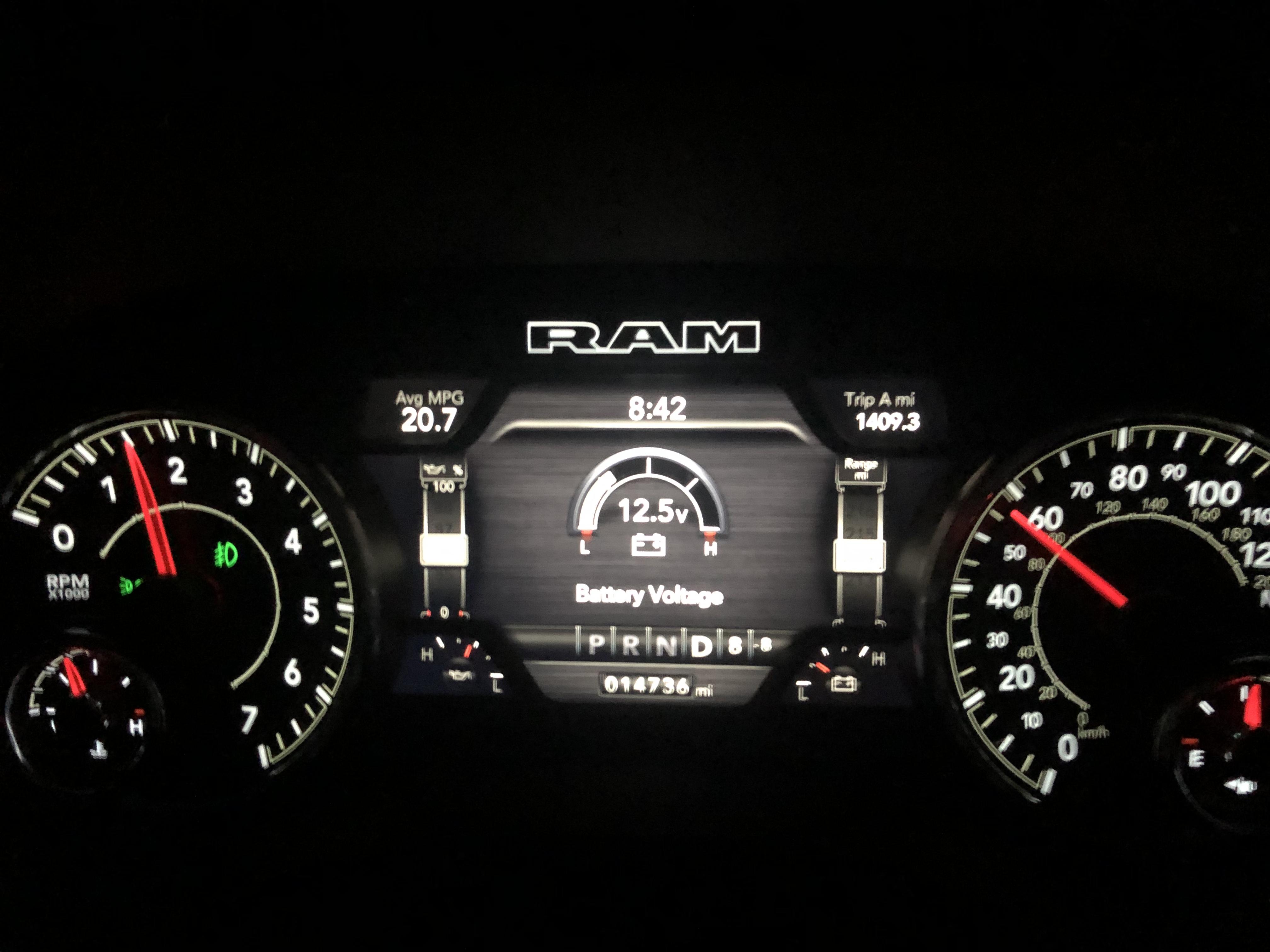

any resolution from the dealership? I’m in the intermittent charging club too..
cj7
Jul 9, 2019
600
369
MD
Jnav, that says the engine alternator is not charging the battery...

Thanks for the response. I agree, and on a normal truck I’d know to pull the alternator and have it benched or replaced. With the Etorque system You’ve got the MGU, 48v battery, dc-dc converter, and more! Where the heck do I start.
12.6 volts at 75mph an hour into the trip just can’t be right.

Yes, same. @RamCares is this concerning? No warnings on the dash for me, but considering it takes 12.9v to charge the battery the truck is apparently not receiving a charge during the entire trip.
